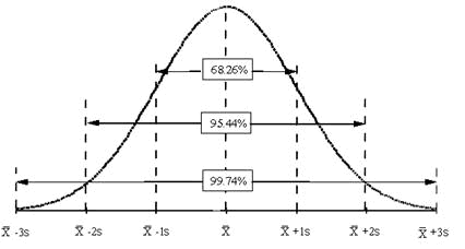

I presume you are talking about velocity? To answer that question correctly you really need to know the width of your velocity sweet spot as determined by a ladder test. Once you know the velocity that puts you in the center of that band of acceptable velocities, then you can calculate your probability of being within that band by adding and subtracting 1, 2 and 3 standard deviations to the center value. See the graph below. If your band for example is from -1 standard deviation to +1 standard deviation, then your chances of being within that range for future shots is 68%. If your band is from -2 to +2 standard deviations, then your chances of staying within it is 95.4%. The standard deviation of 5 shots is rather meaningless. You need the standard deviation of at least 20-25 shots to get statistically valid data.
