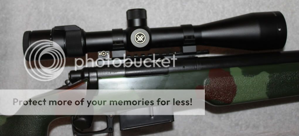

Just got my .223 mags yesterday and the AICS 1.5 stock arrived today. Hopefully I'll get a chance to try it out this weekend. Going to put it all together tonight. Will advise how it all works after playing at the range.
(Yes I know it's a Savage, but a R700 will look damn near the same) :p
2.560" is what I measure from front to back internally, I would think
2.550" or less OAL and you're good to go. For reference the rounds in the mag are 40 gr V-max loaded to 2.26" OAL
