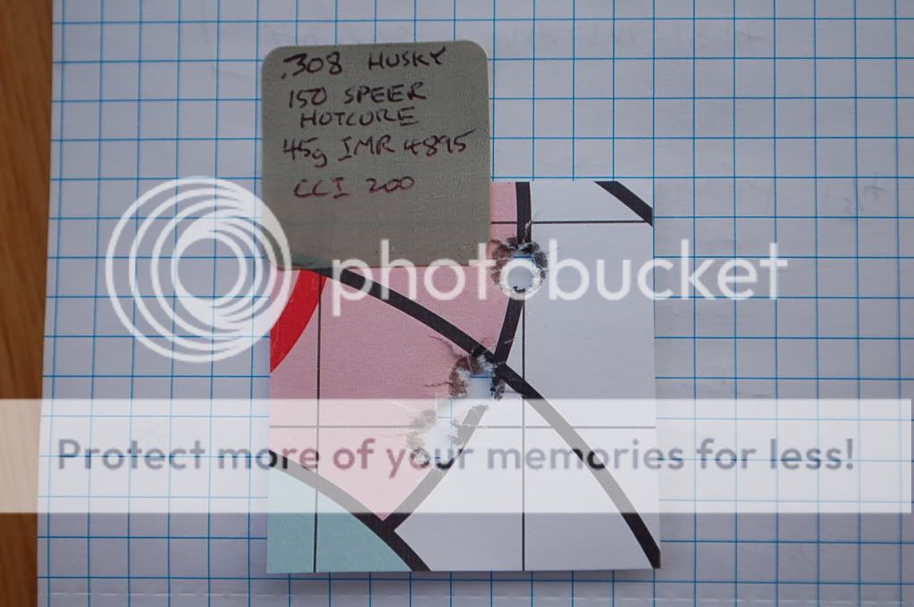

I have only tried 150 grn .30 cal speers in my .308, but found them to be plenty accurate. I can group 3 shots close to an inch which is probably about my limit with an aperature sight. (A Williams FP on a Husky lightweight). I was also quite pleased with the results on a moose I took a couple days ago, the bullet stopped just under the hide on the far side, nicely mushroomed. The range was 40 yds, and the recovered bullet weighed 124 grns.
[/IMG]
