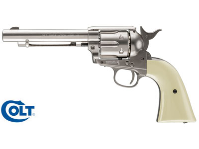

However, more to your question. You specifically are looking for revolvers. Well there is one that may be of interest to you - Colt Peacemaker Single Action Army revolvers:
- Nickel Plated: http://www.pyramydair.com/s/m/Colt_Peacemaker_SAA_CO2_Revolver_Nickel/3568

Crossman Vigilante has a rifled barrel. I am not aware of any other revolver pellet guns with a rifled barrel. Most are just plain barrels for BBs. The colts look nice but I doubt they are as accurate.
