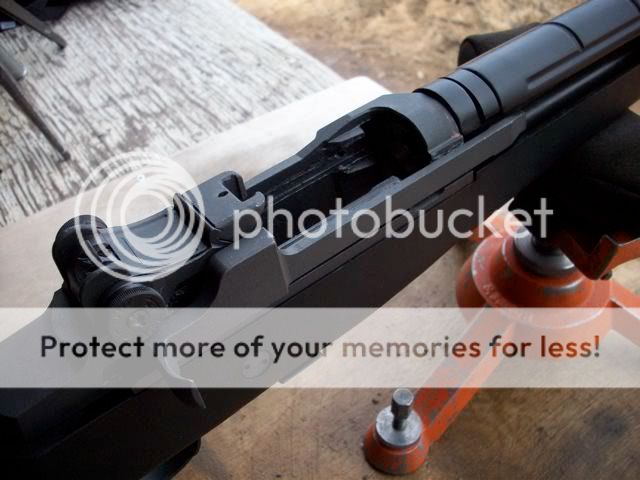

The worksmanship was excellent. The gun looks great, balances well and everything moves and fits nicely. Tom said I was lucky in that this particular Polytech was very tight to begin with with excellent tolerances- tighter than NATO specs in some areas. I really like the Dlask Nav-14 flash hider. The black stock gives it a nice appearance as well.

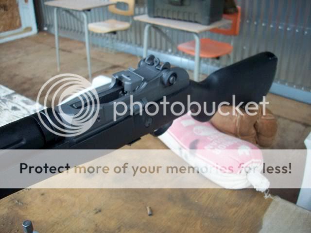

Trigger was smooth with no stacking or creep, very consistent pull. Tom installed a high front sight which worked out well for me when zeroing it.

Shorty Barrel: Might be some velocity loss but no accuracy loss on this gun. Also note the high front sight.
Nice tight action.

What type of front sight setup is this?
How did you put the front sight on top of the gas system?
Please do tell as the only front sight mod I have seen is from Bit's & Piece's gas lock but never on the gas assembely.
^^^^ well..... first we make up a base block of chromoly steel with a dovetail the same as the m14 sight dovetail and base but designed to be slightly higher as the closer you bring the front and rear sight together..... the higher the post must sit to correctly zero elevation wise.
then we take the gas cylinder and assemble it into the heat sink jig and bolt up the fixture that holds the front sight base block in position on the forward ring of the gas cylinder. Then, my good friend and master welder uses his TIG torch to expertly and permanently attach the front sight base block to the gas system. The welds are so smooth that little detailing is required, then a polish and then, while i'd rather be parkerizing, the area is blued up to a nice black that blends well with the parkerizing. I have a large parkerizing station being built at TonyG's but his work schedule and my moving 5 hours away has stalled that into a winter project :)
then on goes the original front sight and it's off to the range to dial it in. This is not a modification you can send your gas system in for. I only do this mod for folks booking accurized shorty work as it is a fairly intensive process.
