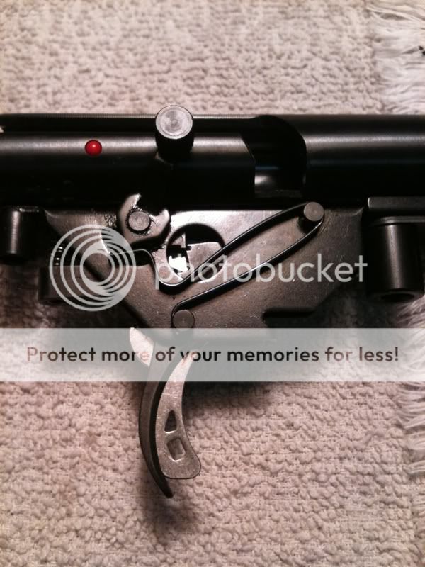

Ok picture tutorial, with gun UNloaded... Obviously.

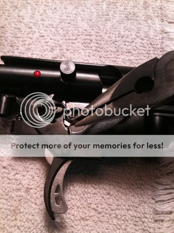

Remove safety spring

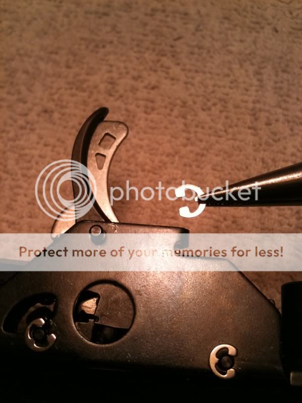

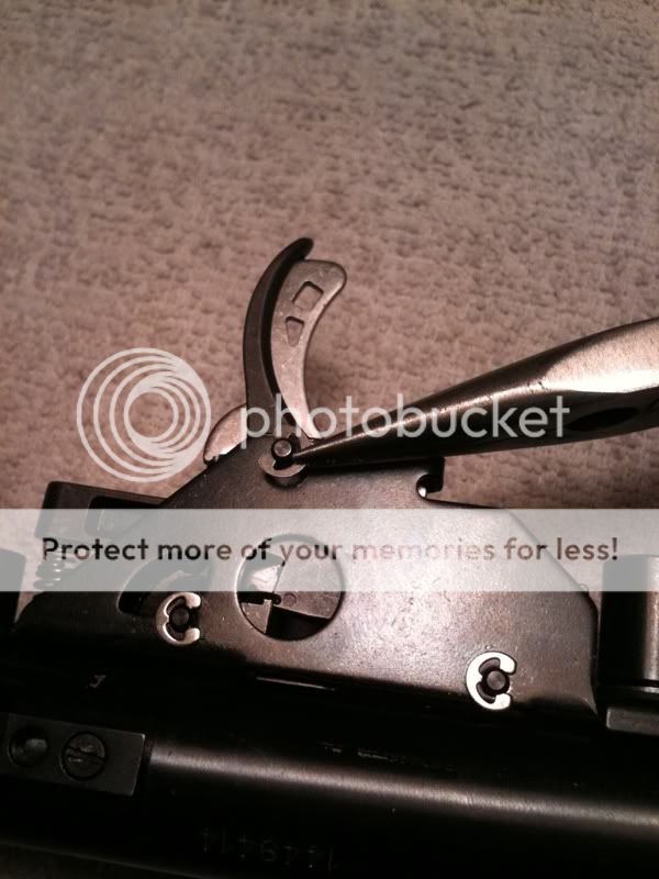

Push trigger pin through and remove E-clip from opposite side carefully, can be dine inside a bag if you don't trust yourself not to lose it.

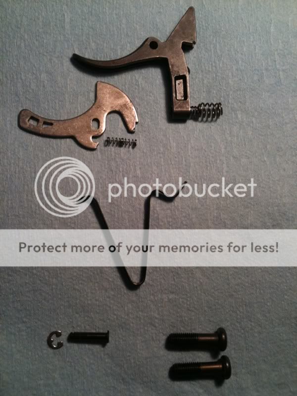

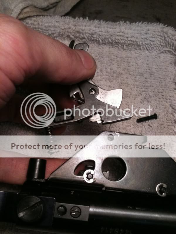

Remove pin, trigger and safety sear. Again be careful not to lose the safety sear spring.
A smart tinkerer keeps a close watch on his parts. Try to keep things neat and orderly so as not to lose anything. I keep a blue shop towel laid out for parts, but sometimes use an ol golf ball box if I have a lot of parts.

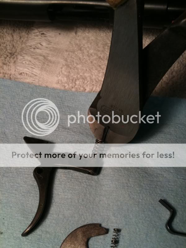

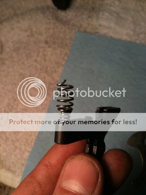

Next you want to clip several coils from the end indicated here. Dont take too many off right away, start with maybe 3 and test it out, if you want it lighter you can always take it apart again and cut more off. You can't put more back once you've gone too far. Baby steps.

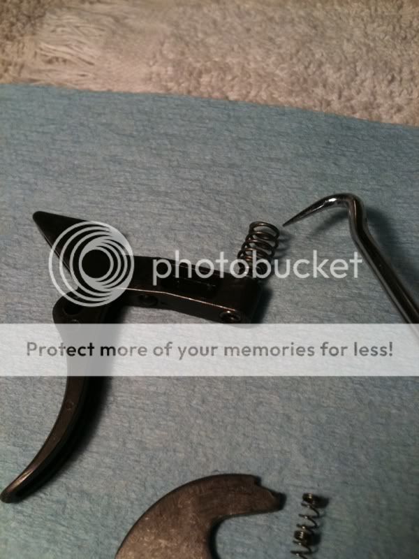

Next, you can (but don't "need" to) put a slight bent in the top of the coil spring so it sticks up into the index that is cut out for it. You'll see the little hole I'm talking about right in front of the recoil lug. This just helps keep the spring centered and turn without sticking when adjusting. If it doesn't stick though, you don't need to do it, the spring isn't going anywhere. I did because I'm anal about doing things properly.
You can't really tell in this pic but it sticks up centered in the middle of the spring.
