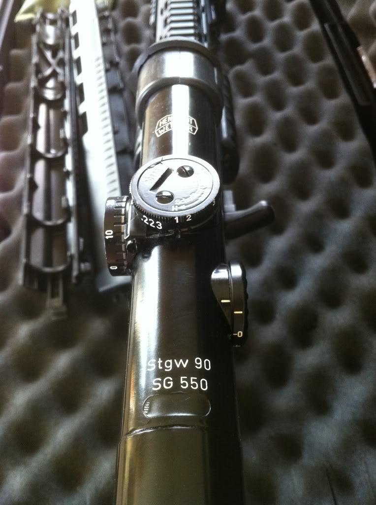

Here's your answer, built for your SAN
http://www.canadiangunnutz.com/forum/showthread.php/973896-Hensoldt-Wetzlar-Optics
