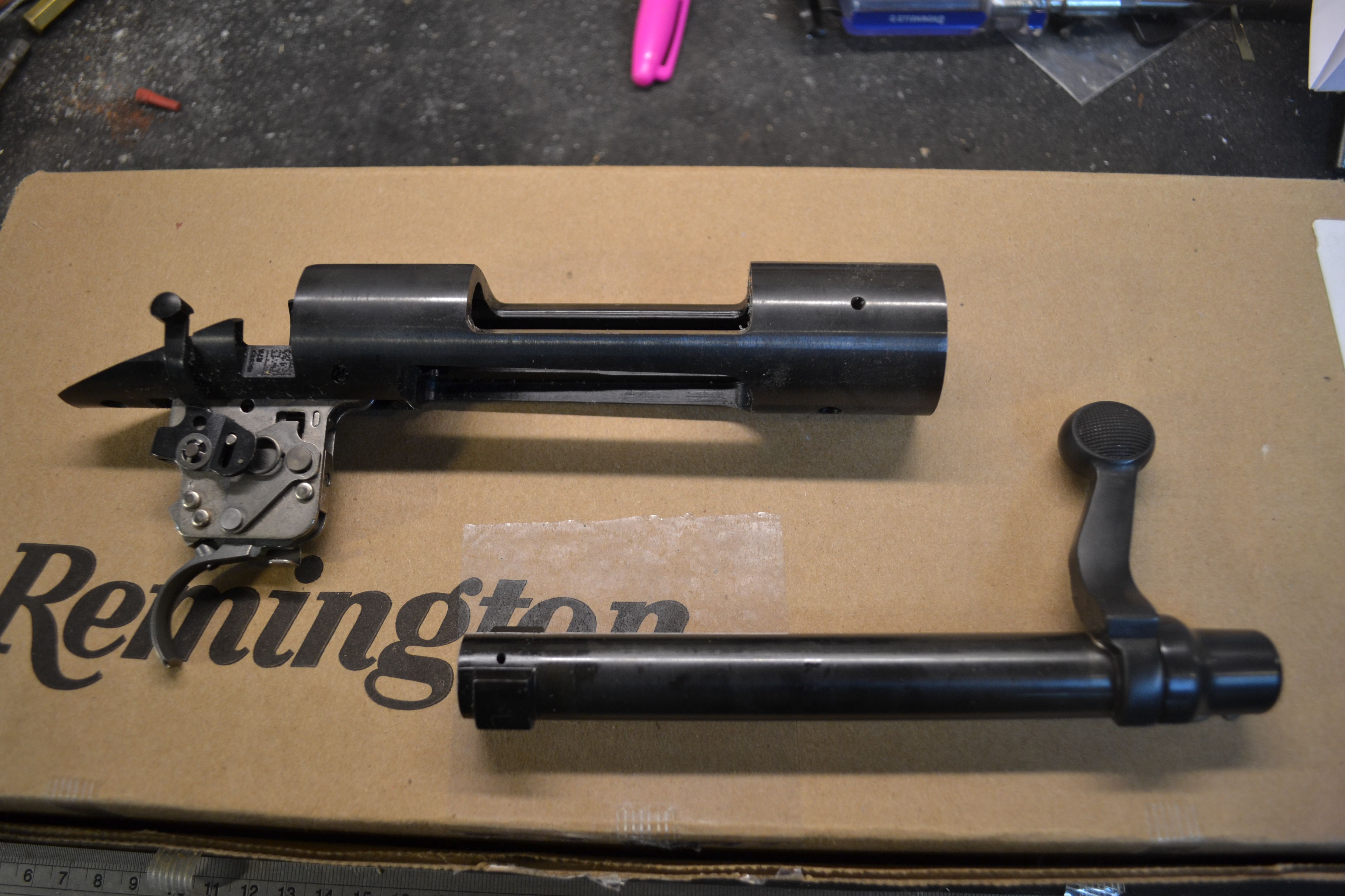

The biggest features a custom offers (depending on the model) is an integral rail and recoil lug. I have a 700 in 7mag and it's a good hunting rifle but for a target gun I prefer a receiver with enclosed ejection port and integral rail. Most customs have more material enclosing the action where the 700 is an open design.

If you want accurate, the action must be stiff. In these pictures you can see in particular the steel across the top of the ejection port which provides whats needed to support the heavy barrel. Now alternatively... you could silver solder a steel picatinniy rail to the top of a Remmy and get the functionality for cheap.
The advantage grows with calibre and barrel length/weight.
You can get by with a light action in 223 because the basic mechanical stresses and impulses are low.
Once you get into a 308 or similar, the difference is clear.
