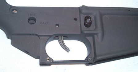

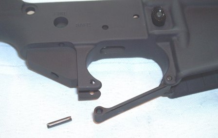

This is what he's talking about. On the forward pin you can only access it from one side so how the hell to you get that pin out??? Im curious now...
EDIT: Oh is that the plunger pin you speak of, that only needs to be depressed???
Yes, look at the two pictures above. In your picture the mag well is on the left, in the two pictures where you see it, its on the right...
Before I figured out that you just had to depress the little button, I very carefully removed the tiny roll pin that retains the spring.
