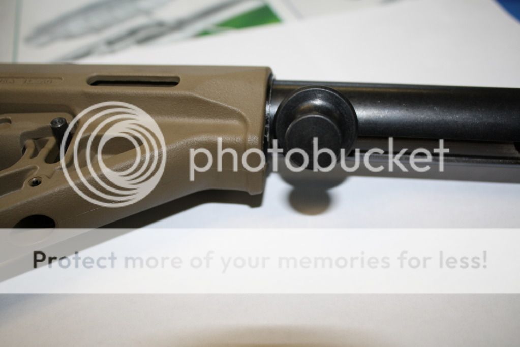

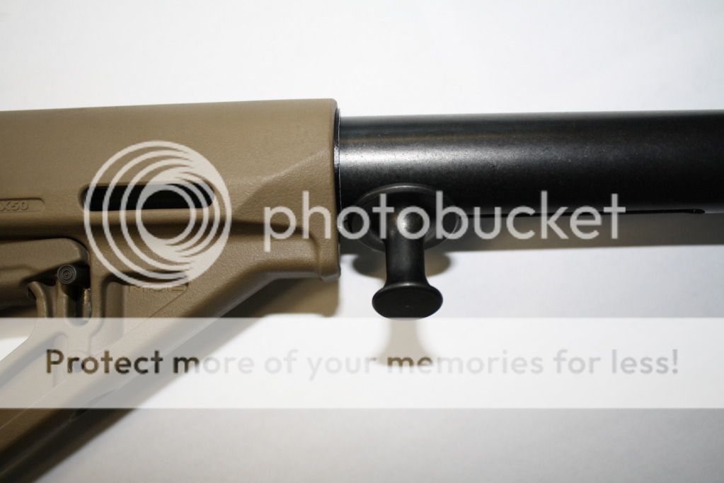

My overal goal was to keep all factory parts un modified in case I wanted to return it back to its original shape. I had to come up with a shorter pin to hold the buffer so I cut down a bolt.
Now here is where some of the picture taking stopped as I got excited it was all coming together the way I wanted. But next the modified buffer tube was drilled so that the pin can be removed for cleaning without any extra work accept to remove the butt pad.
pic showing the buffer nicely tucked into the buffer tube

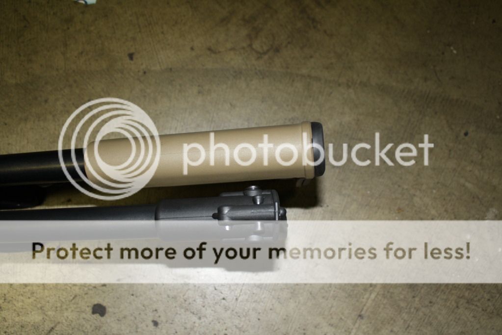

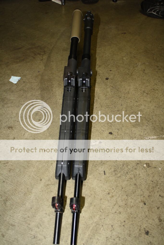

Well thats pretty much it. Still waiting for my tube cover from "tacticool.com" should make the overal tube dimension look a little closer to dimension of the buffer tube. On to the next project gettng rid of that ugly forend. Magpul going on there aswell. And yes the adjustable trigger works. In its fully collapsed setting its a little shorter that stock and full length adds about 3"
