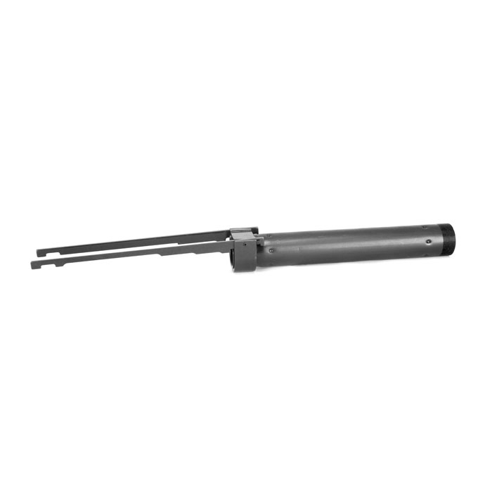

Be aware that Mossberg changed things with their foreends about 10 years ago. It used to be that the foreend mounted to a tube, and the action bars mounted to that tube as well. Now they have done away with the tube as a separate part and the action bars mount straight to the foreend.
Just be aware, it would suck to drop $$ on an old set only to realize after the fact that you can't put them on your gun without buying more stuff.
Here is the tube I speak of:

Hey thanks a lot man! I didn't realize this. It's looking more and more like I will buy the new furniture.

When it comes to the Shockwave, it's not a pinned on pump, but a shorter pump sleeve (6 ¾" instead of 7 ⅝"). So OP will just have to make sure the wood fits the shorter pump or modify it to do so.

Just be aware that the Shockwave has a shorter forend so you’ll have to modify the forend to fit, unless you score one from a Nightstick.

Good point about the forend. I did write and confirm part numbers with Mossberg. The 6 3/4" forend is the one needed for a shockwave.
Thanks to everyone who helped. I ended up making a deal on a factory walnut set off a retrograde. The slide is the longer one, but I'm hoping to use a Dremel and get it to fit. Fingers crossed.
A final update for anyone who may be interested:
I bought a factory 500 hardwood set from an outfit called "Western Gun Parts" in Edmonton. They are listed as a parts source on Mossbergs website. This had the shorter forend and bolted up to the shockwave perfectly.
