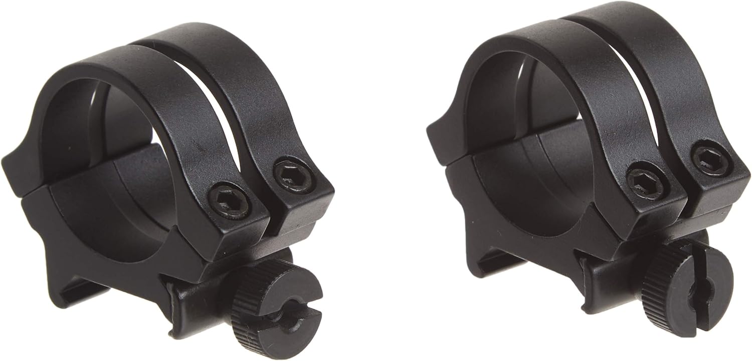

Posted under another section -- probably the wrong place to ask. have a 10/22 stainless that came with a attached stainless rail. looking for recommendations for rings that will fit. Rings that came with the scope are too narrow to fit (1" rings). Will weaver quads do, if not what are my options for budget rings for hunting rabbits & birds/plinking - thanks
Weaver quad locks will work fine if you can get them for a decent price.
Sounds like maybe the rings that came with the scope are for a 3/8" rimfire groove and you need something for a weaver type rail.

The rings that came with the scope we'll call .22-type rings, or 3/8"-type rings, and the rail that came with your Ruger requires 'Weaver'-type rings (or what Leupold calls cross-slot rings). A Weaver-type rail has more-narrow slots, compared to a Picatinny-type rail, and Picatinny-type rings generally require wider slots, compared to Weaver-type rings, so while Weaver-type rings will fit a Picatinny-type rail, Picatinny-type rings won't fit onto a Weaver-type rail. All that to say - if you want to use the rail that came with your Ruger - you'll need some Weaver-type rings.
Not sure what's availlable local to you but it looks like Weaver Quad Lock 1-inch Medium Detachable Rings are availlable on Amazon for just under $50 shipped. The Detachable ones have the thumb screw with the cross slot for a coin to tighten.
Ouch I paid 25$ shipped for my mediums, and 22 shipped for my high. Weaver Quad Lock 1inch rings from Amazon. Was only couple years ago.

Same, $22 in Feb 2022.
