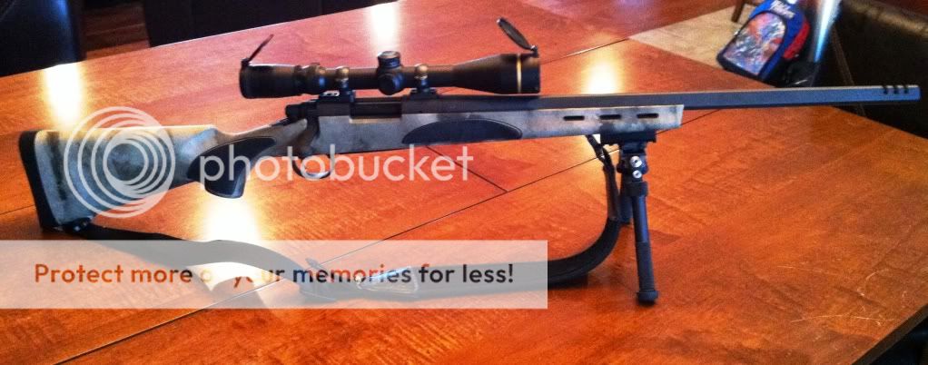

rifle weight and pic
stock vtr, cut the brake off the barrel, leupold 4.5-14x40 scope (no ao, weighs under 13 ozs), leupold DD 2 pc rings and mounts (posted in optics about switching to talleys to save weight), accushot bipod, total weight is 9.5lbs

Fluting bolt and buying new fireing pin might save you max 2oz, expensive and not worth it. Aluminum Weaver bases and scope rings might save you 4oz in weight and pile of money. Scope is good but 6x36 Leupold might save you another 4oz and some $$$ to, cut the 2" of the barrel with the brake and another 4oz bites the dust. Fluting the barrel would get rid of another 4oz easy it being .224" bore the flutes can be rather deep. Thats total one pound allready....Is that stock solid plastic or hollow in the butstock? Drilling holes and routing the forearm might add some more savings. How heavy is that bipod? There is so much choice out there, I bet you can save some oz right there. It is best to plan ahead for light weight rifle but selling some components of yours and buying lighter ones will lighten it up considerably IMO.
