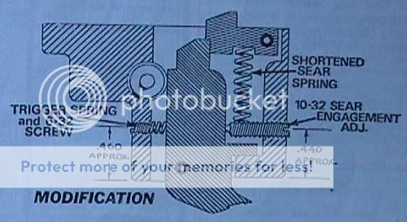

Can't argue that it might be much easier to purchase a Timney. Here is the print.

I bought the Timney (from Brownells - less than 100$ US as of 14 months ago and NO hassle - shipped to my door in less than two weeks and NO paperwork) and installed it in less than 10 minutes. After seeing how to adjust the Timney, the modifications to the factory trigger illustrated above were very simple to do however the Timney is still better. It just feels cheaper because the actual trigger is thinner and it lacks the ribbed feel against your fingertip.
