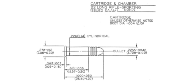

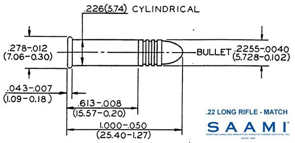

For what it's worth, below are the dimensions to which the ammo is supposed to be manufactured. There will be some variation in dimensions in all components, including bullets. Usually match ammo is held to stricter quality controls and product fails to meet acceptable standards gets downgraded to lesser grades or something similar.
Mikey - Did you measure ammo from 2 or more boxes ? Per the SAAMI spec 0.2255-ish for the bullet and 0.226 for the case is pretty close. Did you measure 'other brands' too ?
