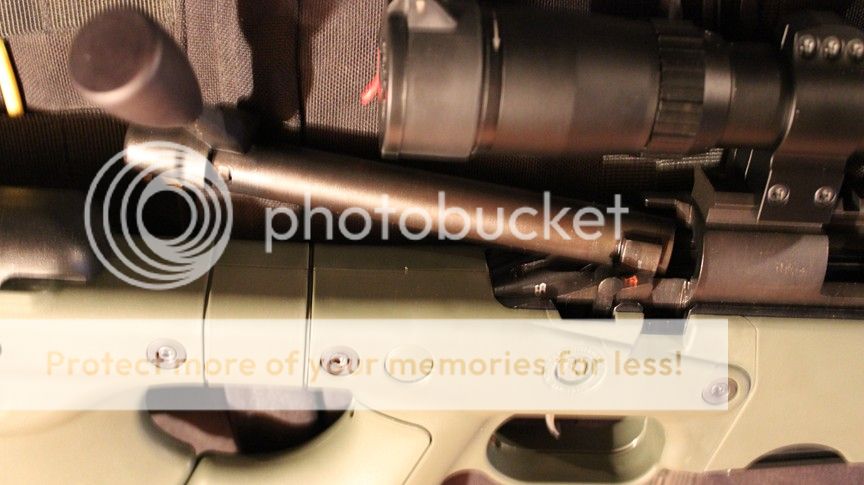

To take the bolt out - or put it in, you have to remove the cheek rest, or fold the stock. No folding stock = you will be removing the cheek rest a lot.

This shows what I mean as between the bolt and the cheek rest. This is a real Artic Warfare, but I don't believe it is any different with a AICS stock with any other action:

To take the bolt out - or put it in, you have to remove the cheek rest, or fold the stock. This shows what I mean as between the bolt and the cheek rest. This is a real Artic Warfare, but I don't believe it is any different with a AICS stock with any other action:
Is that rifle in a "Long Action"..?
I don't have any problem removing the bolt from my Rem700 SA using the AICS 1.5.
There's plenty of clearance..

With a short action Rem 700 in a 2.0, I don't need to remove the cheekpiece or fold the stock to remove the bolt. Or is it possible to adjust the cheekpiece more forward, and that is causing the confusion? Folding is handy for cleaning or looking down the bore.
There's plenty of clearance...
O.K., I'm wrong about generalizing my experience with the AW to the AICS. The AW in the pic is the short action. Definitely cannot get the bolt out without either folding the stock or removing the cheek piece.
