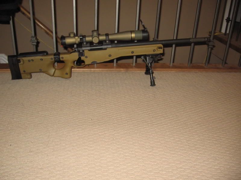

So who's all running a AICS stock on their rifles? Calibre's? Pictures? I just received my dark earth skins from John at Wolverine for my Short Action AICS stock 2.0 that has my Remington 700 in .308 mounted in her ... I'm so happy ... :D ... pics to follow!

I just put on my Dark Earth color skins on my AICS stock on my Remington 700 in .308 ... it looks great ... :D ... gonna take it out this spring and see how she looks with some moss on top of her in the dirt ... ;)

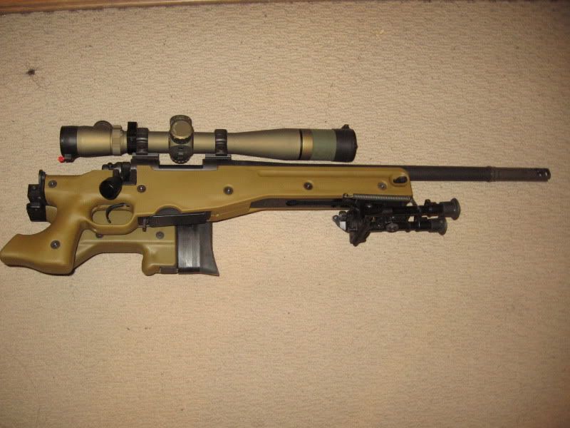

here are the NEW edition, I love the Folded Model!

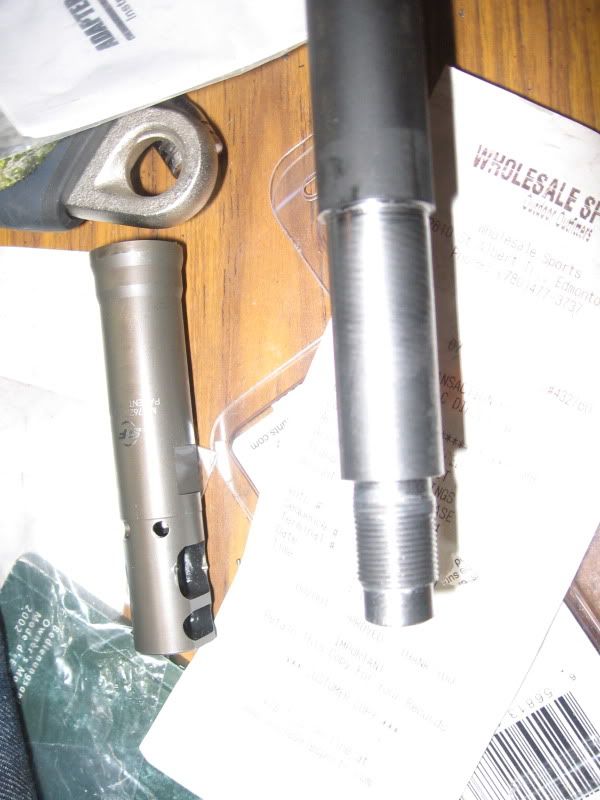

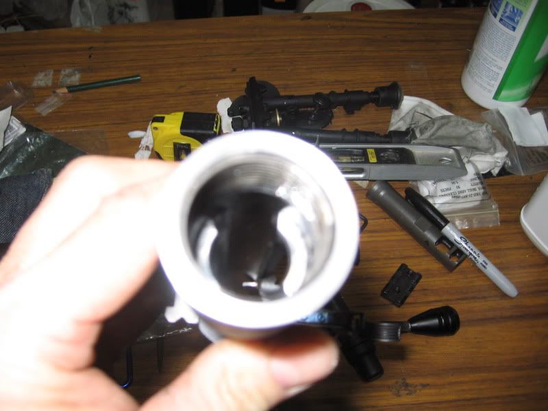

Start out as Rem700PSS 26" barrel, cutted down to 20", do Muzzle break, Match Rechamber, Square Action, and lap Locking Lug...
does 1/4" at 100meter with 168grain, 45Gr BC-2 Powder.
Gunboy ... THAT ROCKS! Did you do the work yourself? Nice ... :D

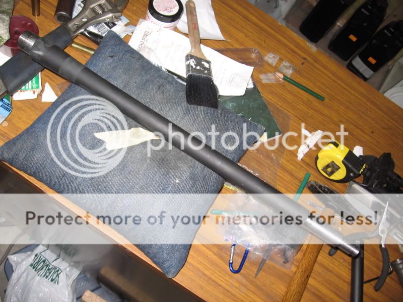

Just finish tonight, the Rifles start out as 26" but I cut it down to 20", rechamber with match reamer, now is as TIght and short lead as The Savage, got 1/4" group at 100meter this AfterNoon, Before I put in the Muzzle break. total time was 2Hour of working on the Lathe.
You should cut down your Barrel, won't loose too much Velocity, I still got 2700fps as compare to 2760 with 45grain of BC-2, 168grain BTHP, also 175grain BTHP I got 2675, this is after cutting the barrel, total loss of speed was around 80. so not too bad, really nice and short... you like it man, thank you for the complement...

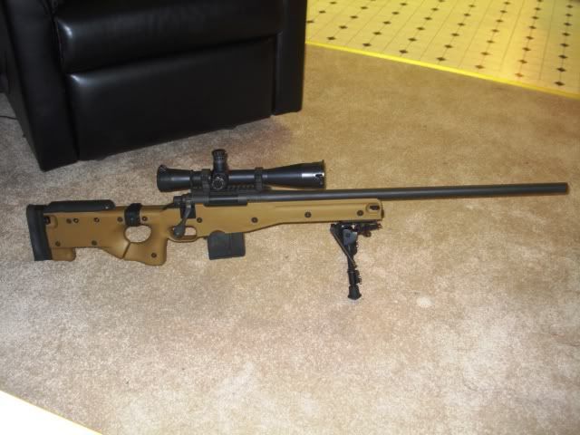

Here is the other with NF, S&B, and Handsolft... I din't eat for Year to save up...
ENJOY, YOU GUY!
I LOVE AICS. The Best thing that Happen to a Remington!

Very nice looking rifles. Can you tell us about the attachment on the bottom of the rear stock? It looks like some sort of rear rest pod.
