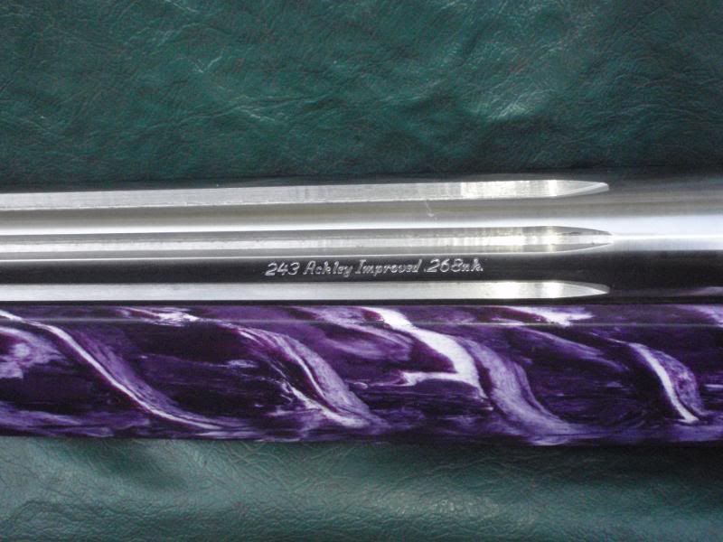

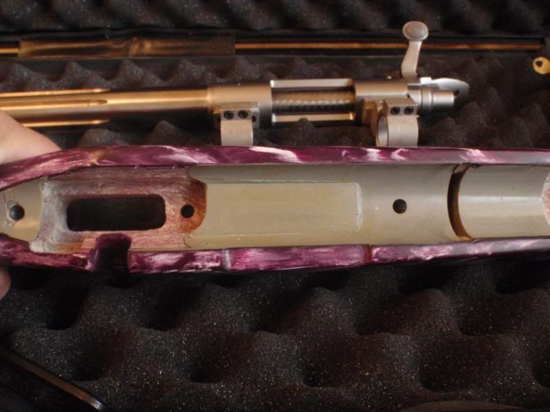

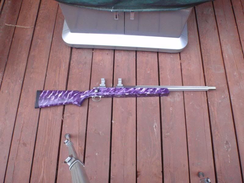

Okay thanks, I have A Remington 700 like I said. It is chambered in .243 Ackley Improved with A heavy stainless steel barrel that is 1" at the muzzle and fluted. As it sits now it is in A McMillan Bench rest stock which is A nice stock but it's not what I need it's just too heavy and I cannot mount A bi-pod to it. This rig is going to be for all my varmint hunting needs and will be out fitted with A Leupold Mark 4 8.5-25 scope. With all this said I will be selling the Bench rest stock as well I don't know what it would be worth( if anyone knows?) here are some pics.
the stock
interesting you have bedded 1½'' after barrel lug, I have been suggested no further than barrel lug
and my rem 700 bedding looks failed cause I put on the actions screws in maybe too tight, but otherwise barrel and action were tilting forward and I would've lost floating of the barrel. I can actually see through bedding material.
however, the aluminum bedding block on my rem700 xcr was already snug (aluminum marks on action) at least the bedding did allow me to achieve proper lug support
