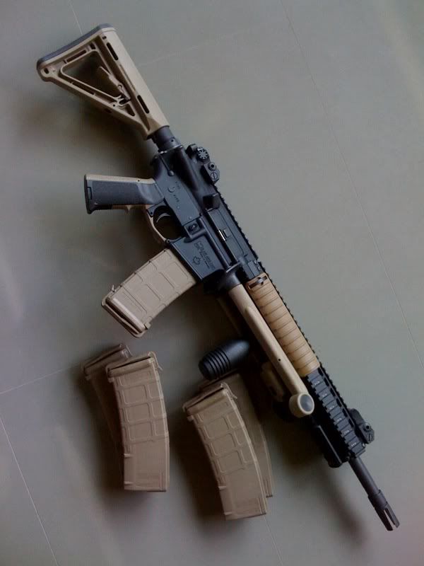

I have an ARMS M68 mount (as in the stock picture above) and had a riser for it. Its a better mount overall but without the riser its a real low cheek weld. Considering I have the QRP and riser it will do for now. i have a fair bit of rail to play with so Im hoping to get the correct eye relief for the 2x.

So you have the ARMS mount, but CURRENTLY without a spacer?
ARMS makes 3 different height spacers for the mount. One 1/4 inch, one 3/8 inch and one half inch spacer.
Wolverine Supplies should have em for you, on their price list its 10.95
Yup ARMS 17 M68 Aimpoint mount. I use one with the RAS II and it co-witnesses perfectly without a riser. I paid too much for the riser spacer at TSE :(
The QRP will work for now (spacers were available locally at Daves Surplus).
