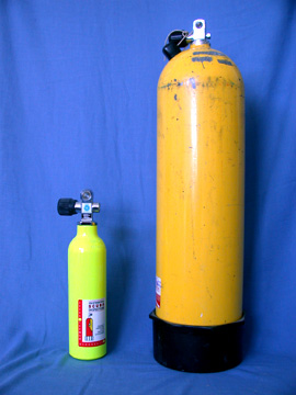

any decent scuba diving place should have compact size tanks. You should look into an emergency tank like this one (left) :
Matter a fact, there are many scuba tank sizes to choose from :
Since that gun fills to 200 bar, you would probably not get too many 200 bar fills with a standard 3000psi scuba tank.....especially if you go with a smaller one.
Gas supply places can provide 6000psi argon fills...another option is to pick up several tanks and cascade them allowing you to use the remaining gas at lower pressure.

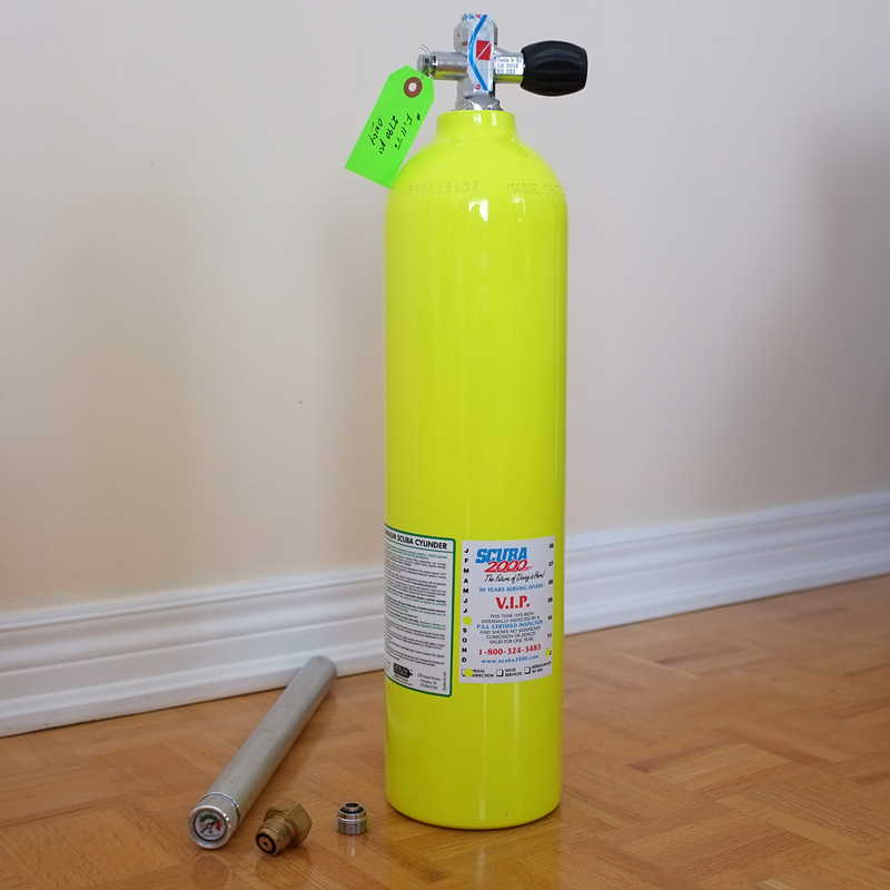

I've bought a Scuba tank from the scuba shop (from www.scuba2000.com - aluminum 30 cu ft, it costed $199 filled).
DIN adaptor (the brass part in the middle) came with the rifle, so I only had to unscrew the tank adaptor (at the right), and put DIN.
Also, I don't remember how many bars they put, but now after 5 or 6 refills I have maximum 160 on my cylinder.
So I think it's better (if you don't have to carry it with you) to buy standard size 80 cu ft tank, fill it once - and then forget for 5 years.
