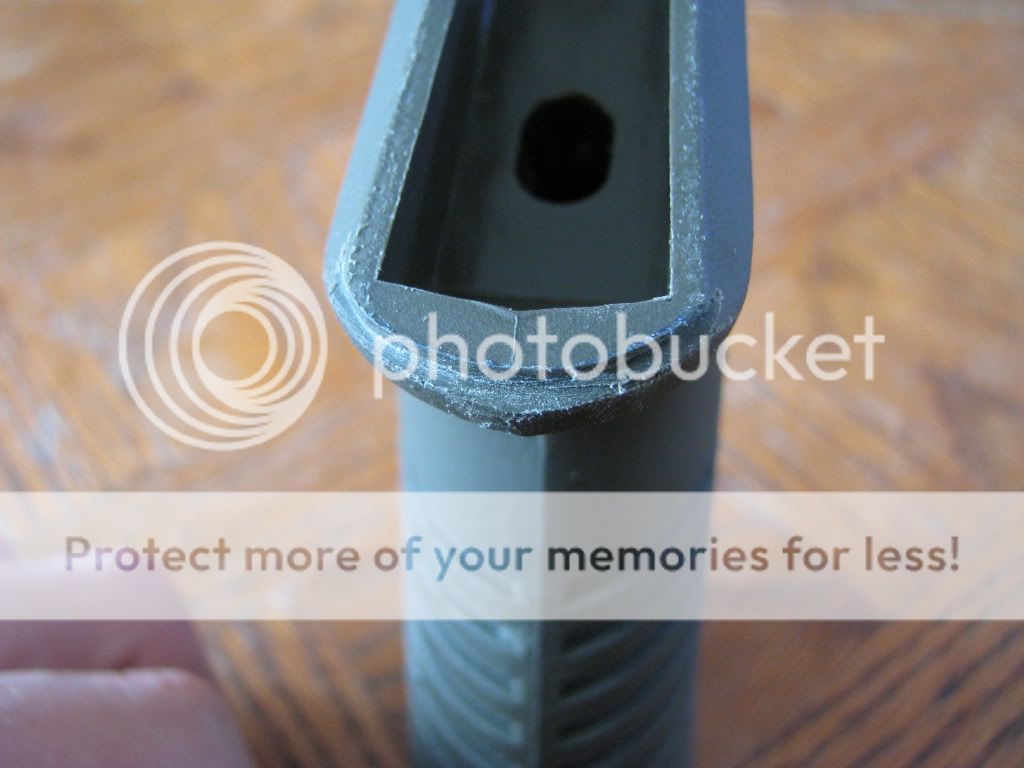

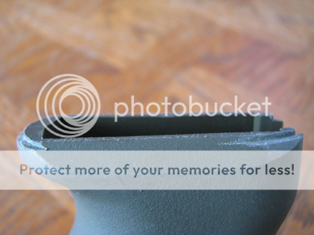

To make an AK grip fit is very easy. all you need to do is file a small bit of material off of the top front and back of the grip. Like this
ETA: This is a Tapco SAW grip, and I think I re-used the stock CZ bolt
I advice to keep the ferrule on the rifle. The grip will wobble even if it doesn't fit in the ferrule perfectly. Take the ak grip and put the cz grip against it top to top. Trace the outline of the cz grip onto the AK. Dremel a few mm down from the top like the pic shown above. Sand it a bit with a disc to make it fit just right. Better to remove little bits than too much. You will have to remove material from the right side as well for the safety to move freely. It's pretty simple. Just take your time. You will need an AK bolt.
