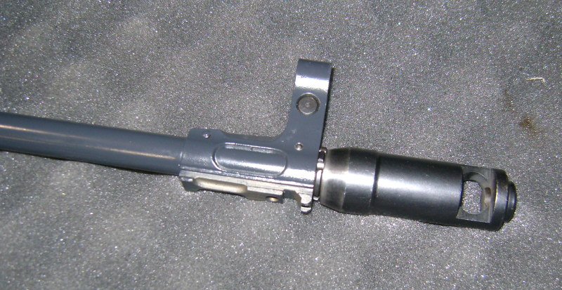

I've had an AK74 muzzle brake kicking around my parts bin for a number of years now. When I got a CZ858 a number of months ago I figured I should put it on there. As most of you know, the threads are the same except one it LH and the other is RH.
I toyed around with drilling it out and installing a helicoil, couldn't find one the right thread size. Thought about boring out the threads in the brake and machining a threaded collar to press into place.

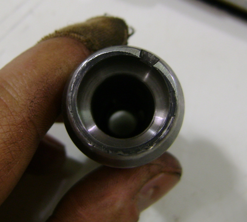

Today I had a brain wave that allowed me to mount the brake on the rifle without spending any money. I simply bored out the threads and made a counter bore large enough to fit the CZ858 thread protector. I left about a .001" interference fit, and pressed it in. I thought about making the fit tighter, but I wanted to be able to adjust the brake so it was aligned properly.
I'll at some welds tomorrow to make everything thing permanent and then re-parkerize it after bead blasting.
Counter bore cut on the lathe
Mounted on the rifle. Actually looks pretty good.
Not too bad for 10 minutes work

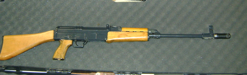

I was origonally going to buy an 858 and "tactical" with rails, folding stock, optics, etc. for 3 gun. I saw that sucker with the wood and just fell in love. It's going to stay bone stock except for a few minor changes.
