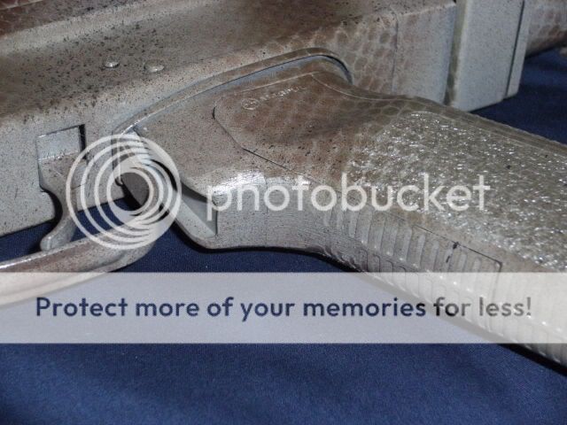

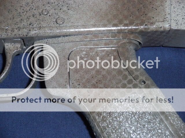

I am running the ACE one with a Magpul MIAD on my 858. I never had to drill another hole in the grip, but I had to trim the tail of the adapter to fit into the metal grip holder. I also used a dremel to conture the front strap to get a better grip.
And no I don't have any adapters or know where to get them. I got mine from Stevo :D
Here are some pics of what I did:

Well I tried to instal it today and 20 minutes latter with the dremel here is what it looks like;
The best thing about this besides the $10 it costed was that I could choose the excate location of were to place the pistol grip. Defenatly 1 mod I would reccomend for anyone who loves the selection of AR pistol grips and would like to see it on there VZ.
