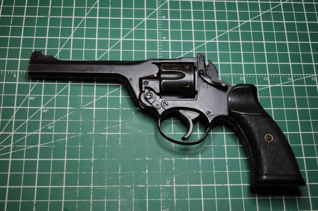

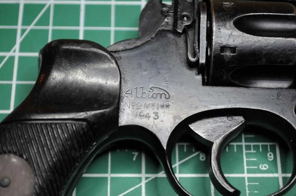

I finally got to bring home my Enfiled revolver from the store today and now I'm just looking for a little more info on my particular pistol. The most I've learned from it is it was made by Albion motors in 1943 serial C5200 and its all matching.

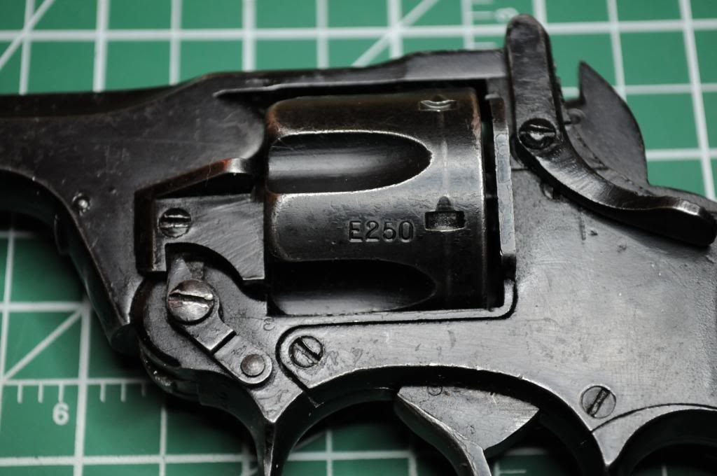

If it's any help, the number on the cylinder is the steel batch number (quality contrrol)

HAC is the Holy Grail of Enfield revolver production, but ALBION is quite scarce enough to be noteworthy.
They built only the modded revolvers, not having been engaged in making such back when the SA/DA option still was open. So all of theirs are DA only and will be Number 2 Mark 1* and Mark 1**.
The Mark 1** was emergency-status production and was regarded as dangerous while it was actually being made. But they needed guns SO badly that they kept on churning them out until the crisis was over.
The Mark 1 was single- and double-action. The Mark 1* was double-action only. The Mark 1** wads double-action only BUT a good smack on the hammer would fire it.

With the gun in the condition as shown in the first photo, hold it up to the light and give a solid push on the Hammer. If the Hammer goes forward (you will be able to see how far by the light coming in between the Cylinder and Standing Breech) far enough to strike a Primer, then the gun has NOT been retrofitted. If loaded, it will fire if you hit the Hammer.
If the gun HAS been retrofitted with the proper Hammer-block, then the Hammer will NOT go forward to strike a primer UNLESS the Trigger has been pulled back all the way. Normally, they are quite solid until the Trigger is pulled; anything else is a trip to the Gunsmith or else, in the case of the Enfield, crowing from the rooftops.
