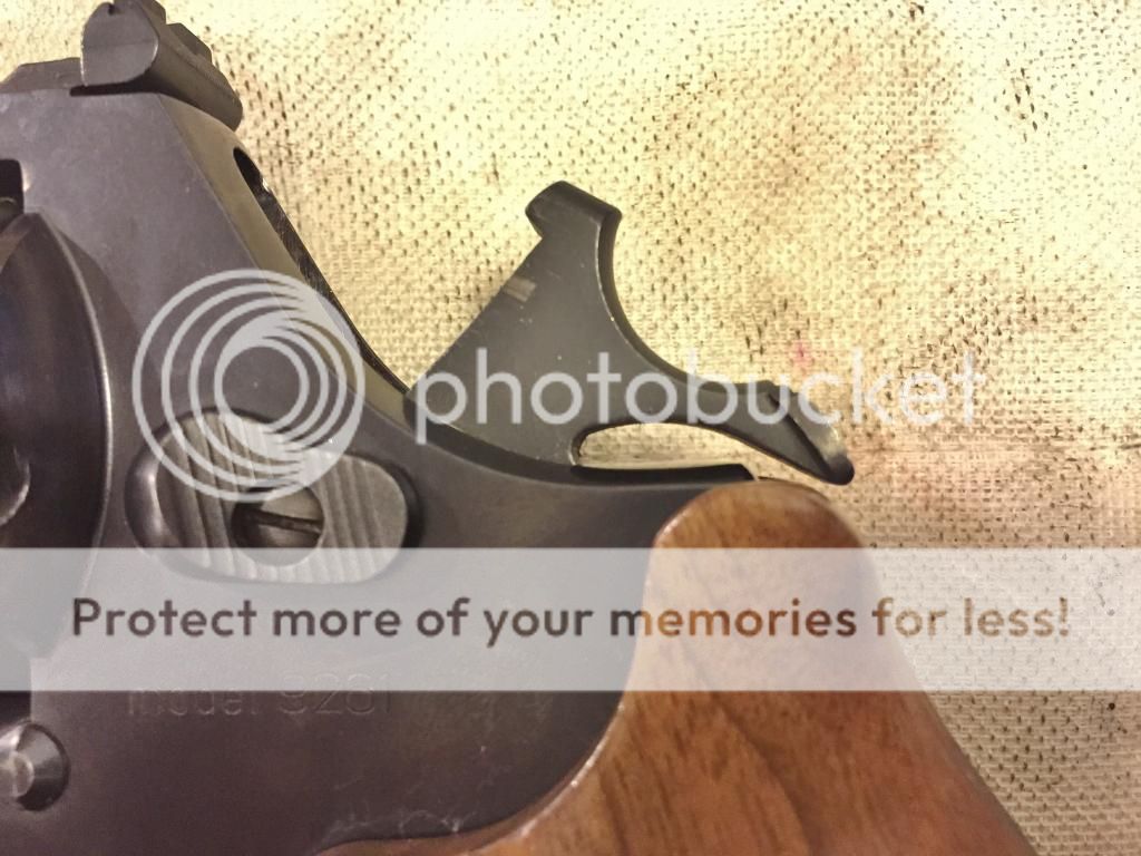

Planning on posting pictures soon. This is my fathers gun and he is in Jamaica on holidays for a few more days.

Here is a picture.
[/URL][/IMG]

If your father likes the fit and feel of the grips then I would simply file away or lightly Dremel away a little of the wood, touch the spot with a coat or two of urethane varnish and call it a day. Another suitable tool would be some medium them fine sandpaper wrapped around a small stick that cuts away a few thou of clearance. It's such a simple bit of fixing that it just doesn't warrant an exchange. Doing the fix needed would take less time and less effort then mailing the grips back. Especially if the grips feel great other than this little issue. Chances are excellent that the next set would fit with the same obstruction anyway.

Which is why you should let who ever you bought the grips from know that they don't fit.... that way they can pass the information up the chain to who ever is making the grips. The contour in that area should ideally match the hammer's contour for aesthetics. Another improvement would be a bit more of a beaver tail so that you could take a high grip without getting pinched by the hammer.
I agree with BC about fixing it your self if you are handy with tools and have something to refinish with.... but I also understand that not everybody has an interest in fixing new products or a supply of tools and clear coats.
Looking at your picture, it appears that the hammer is locked back and just barely touching? Perhaps you can just compress the wood fibre a bit to give you the clearance you need that way there would be no refinishing. Humidity changes may swell the compressed fiber down the road though....

Other owners of these grips have this problem? With extremely small gloves on the hammer would not stay cocked, so it needs 1/8" clearance in my books.

The light glove would just barely get trapped between the hammer and grip.

The grip is probably stained and clear coated with something like Varathane. The clear is easy to retouch but if it is stained, which it looks like it is, you'll have a noticeable blemish. You could try your luck finding a stain that would blend well with what the factory used.
Here's a pic of my 9261 with the stippled walnut grips. I'd say I have ~ 1/16" clearance, and have no problems with setting the hammer back for SA.
Thanks VanMan, I have a side picture coming and will post it. Yours looks better. If RW will pay shipping both ways, I will send it off. I could also sand all the smooth areas of the grip and redo the finish.
Common fitting problem, known to exist for some time now. As mentioned u can either lightly sand or contact the distributor(Blue Line) for proper grips.
