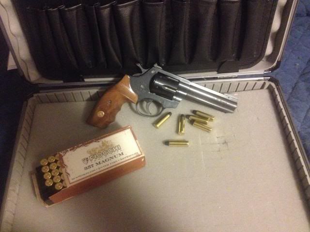

Has anyone seen or heard of a speed loader for the alfa-proj revolvers? I've had quite a few people say they look like a smith, so i'm wondering if a S&W 626 speedloader would work for it. Any ideas?
Since all gun threads are useless without pics
no, a moon clip or half moon clip would not work. the cylinder would never close. A speedloader works on the moonclip principle, however it releases the ammunition. it essentiall hold the ammo in a patern that will line up with the chambers in the cylinder so that you can dump the empty brass and fill the void with fresh ammo.
