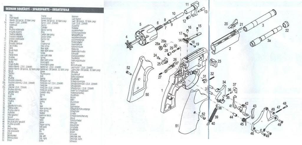

Just received my new Alfa Proj .22LR revolver and quite liked the look and feel of it. I bought it with the reduced powder spring tune kit and tried to install it today. The gun is unfired.
When I removed the plate, what looks like the trigger return spring guide, trigger return spring, pawl, and what I think is the bolt jumped out and fell on the floor and table. I gathered them all up but now don't know how to assemble the trigger return spring guide and trigger return spring.
Anyone know where I can get an exploded view of the revolver in question or a pic of one assembled but with the plate removed so I can finish putting it back together?

In the side plate there is also a small spring and a pin that is the tensioning pin for the hand. You push it in and pass a small wire through a hole you access from the outside face of the side plate to hold it in place until the plate is re-installed then you remove the wire to let the pin press against the back of the hand.
Thanks BCRider. Between your picture and what I managed to find on the Internet (but strictly by accident, fortunately) I was able to put it back together again. I'm posting the pics of what I found here for any future CGNers who run into the same problem:
