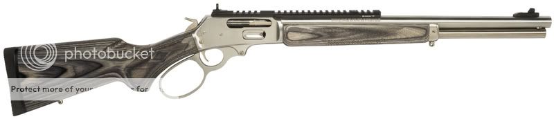

Wait for the new Marlin that's supposed to come out in 45-70
I have to have one of those when they come out! Have to damit:D
Looks just like my XLR .45-70 with a sawed off barrel and a.....a.....fish scaler/backscratcher mounted on it. I'd stick with the longer barrel - makes a substantial difference in velocity and recoil and any handloader can easily outdo the .450 Marlin with the .45-70, plus brass isn't so proprietary (read less expensive and way more available) as it is with the .450's.
Why the stupid large-loop lever? I can see the extended base for a scout-style scope (if you're not worried about your #### dropping off from scopign a lever) but that ridiculous John Wayne Wannabe lever has to go. I can see makign it slightly larger for guys wearign gloves, but that one still looks too big to make rapid cycling of the action feasible.
