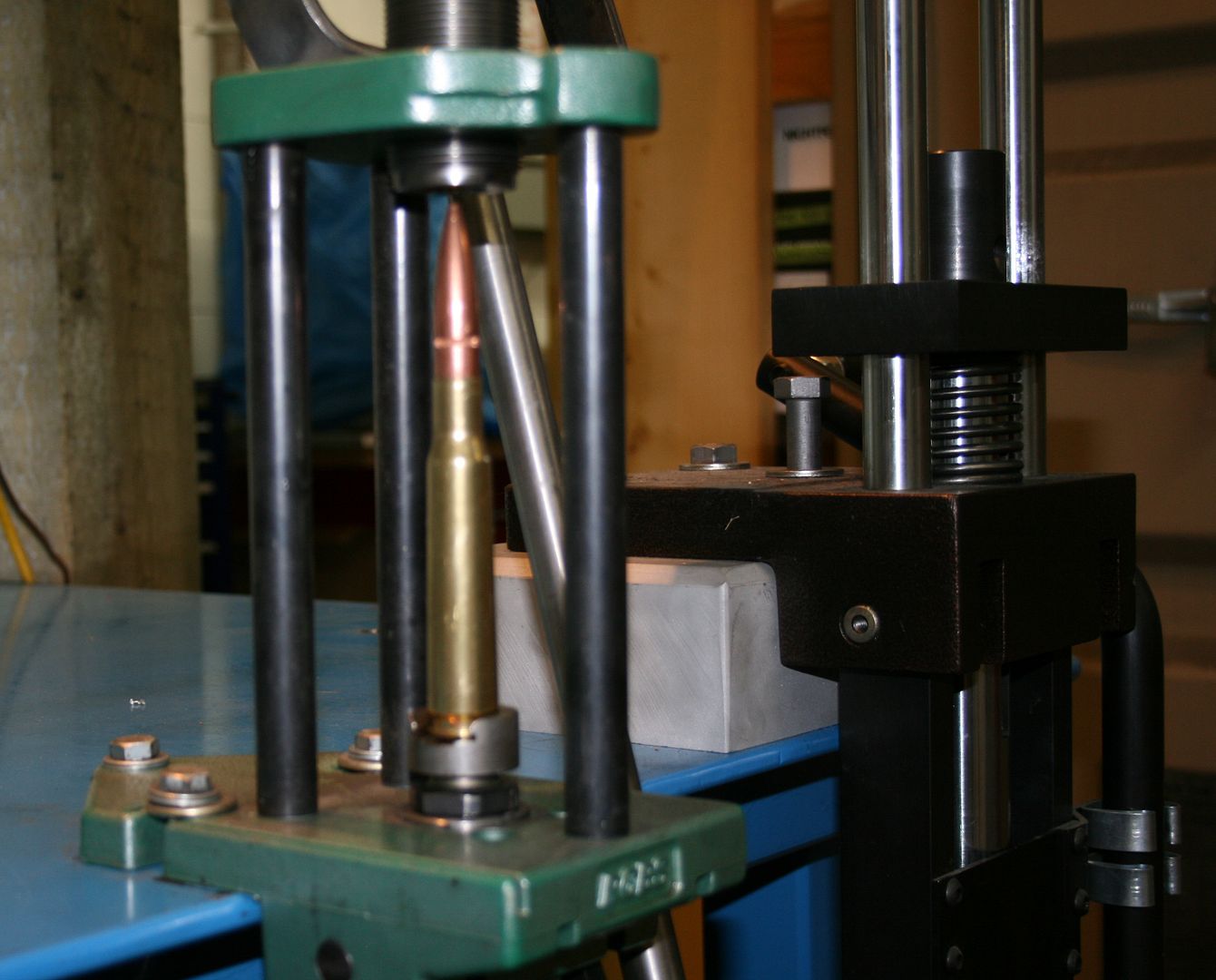

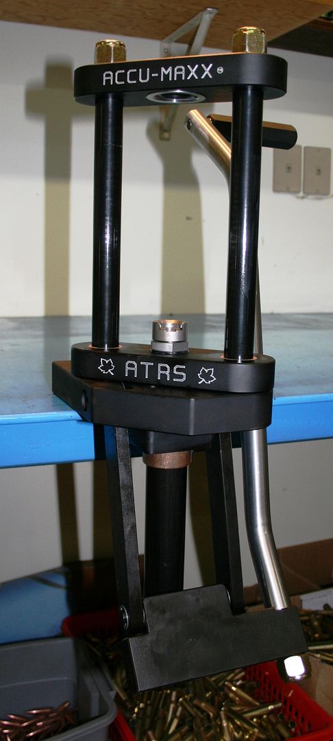

This is what we came up with.
A press where EVERY moving part runs on bearings or bushings. A press that can be used to reload everything from 25ACP to 50 BMG, it can use both 50BMG dies and any 7/8x14 TPI dies, either RCBS, Redding or Hornady shell holders.
The primers drop through the ram and discharge out the back into any container that fits under the press. It is available in either a right or left hand version.
It has far more mechanical advantage than any of the presses we have to compare it to, based on a non scientific sizing a casing test.
The photos are of the prototype, the finished product will be hard anodized blue on the base, ram guide and top plate, roller handle, the ram and guide bars will be salt bath nitrided. We have not decided whether to nitride the stainless steel handle bar or not yet.
This is what the same 50BMG casing and bullet look like in a set up 50 BMG Ammomaster for comparison sake.

Size of the ram? 1.5"
Type of material used? Ram, guide rods, handle, virtually anything that can wear or be stressed, 416 stainless steel.
The non wear parts like base, guide plate, top plate 7 series aluminum. The top plate has a stainless steel insert so repeated installation of dies will not effect the threads. The insert will be nitrided as well.
Video of it operating? Hope to shoot 1 during Christmas break.
