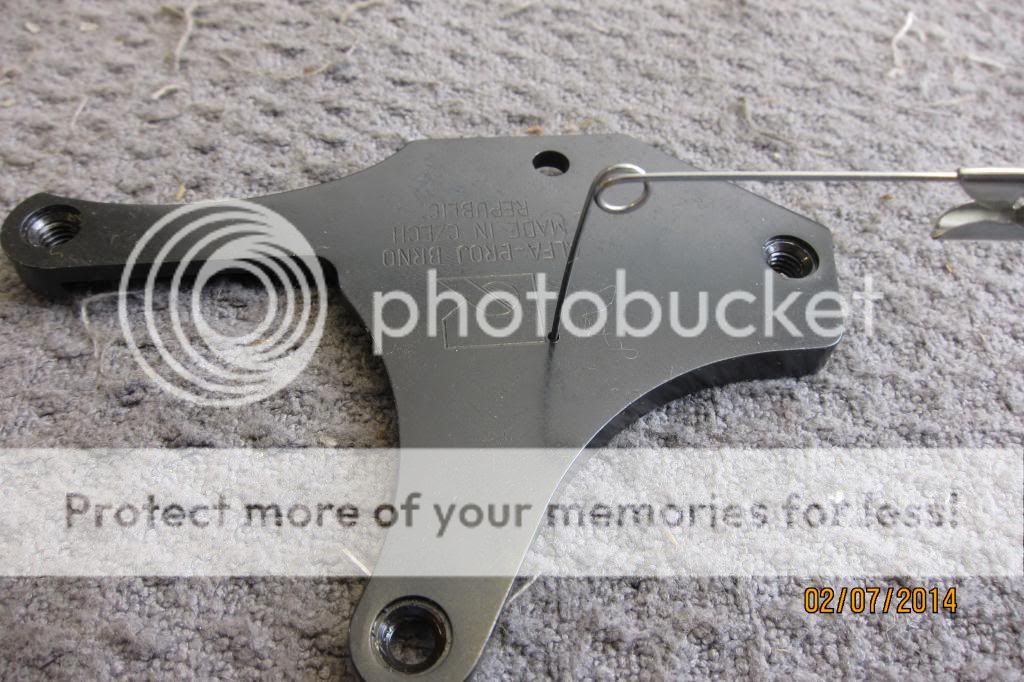

Your cylinder stop and spring looks different than mine. Maybe check the position of the spring? Also, there is a trick to putting the plate back in. You have to trap the #48 pin and #47 spring retracted using a small pin pushed through the side plate. There's a couple of pics below of that.
Thanks for this although by the look of your trigger assembly, you have something a little different.. That trapped spring trick was something I had to do to get the main spring pin assembly back in position.. I will try it with the cover although it's as if the hammer pin doesn't quite line up with the little bore in the cover..
Yes, mine is a 9mm 9261 and it does look like the locking lug mechanism is different than yours. The trapped spring I mentioned is not for the main spring though. It's for the spring and pin that pushes against the #43 "Hand" that indexes the cylinder as you pull back the trigger. If you don't trap it back in position as you put on the side plate, the pin is probably getting caught between the Hand and the Side Plate which will definitely bind your trigger action.
