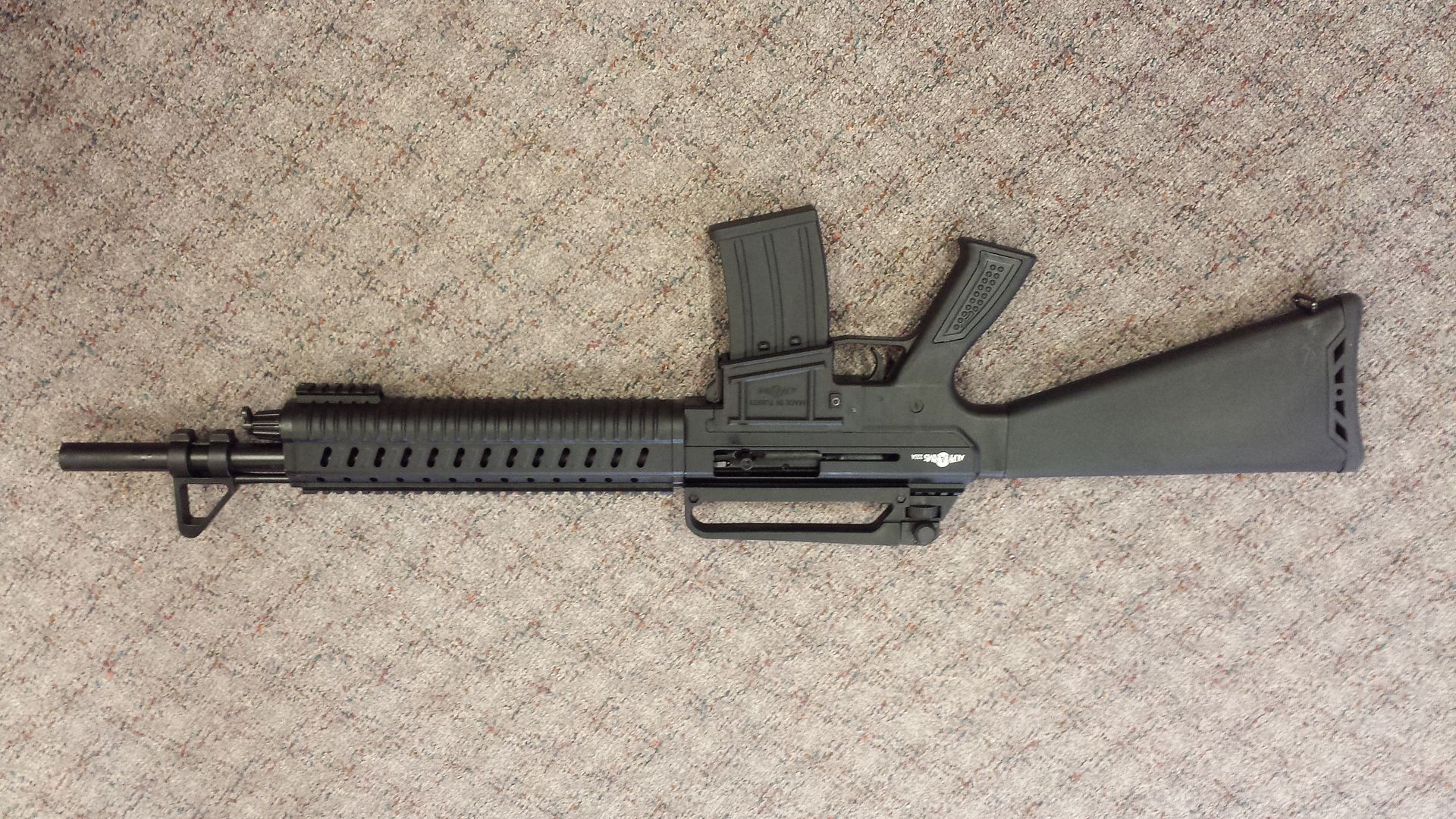

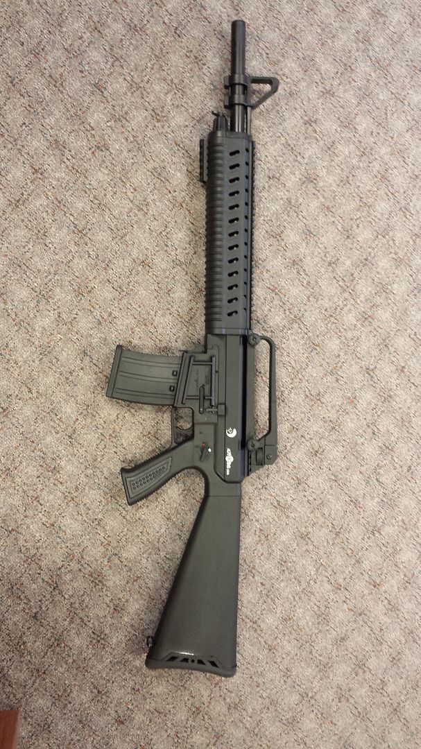

^^ sorry damn iPhone. Was trying to say all I have seen is pictures of folding stocks, did you Unbox any fixed stock rifles? And if so can you post a picture please. Curious if front guard is the same and what the overall look is. I know you only had a handful of fixed stocks in the order, if they shipped any.

Sorry Johnny, thought I got back to you, check em out.

Wolverine 303. ... Thank you sir for posting the full stock pics. Those look awesome!!
My thoughts exactly, Glad I got my name on that 3rd fixed stock, got the shipping notice today! Can't Wait! Thanks for all work to everyone at Wolverine in getting these certified NR and imported!
