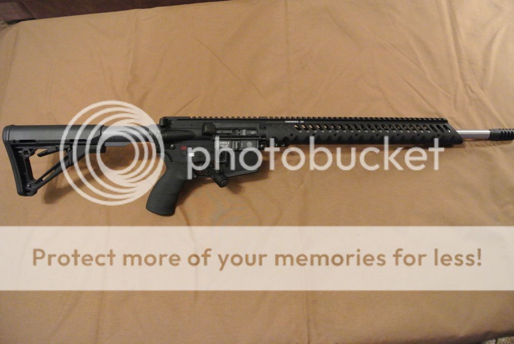

So I'm trying to find a new mount for an optic on my AR. The optic is a sightron SIII 6-24x50. I've been looking at the American defense recon mounts, only issue is I can only find the H mount in stock which is the highest of their mounts. So I know the H mount will technically work but I'm worried it will be to high. Does anyone have any experience with the H mount or should I just wait for the normal recon mount?
This is the AR it will be going on.

The ideal height for your application is about 1.5" ( Larue SPR mount and standard ADM ) . The H mount is a bit high ( IIRC its 2" ) for your application and you will find it annoying

There are several forum supporting dealers that have ADM / vortex mounts (ADM makes it for vortex): One Shot Tactical & SFRC to name a few. You want to keep it as low as possible. The pic shown sporting a 56mm obj would indicate you can make do with the standard height mount.
