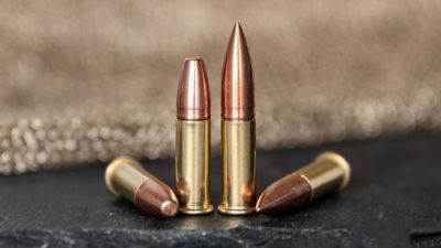

For best results with 1:12 barrels it's a well-known secret that the best ammo is the following because of their shape and diameter and weight. No one should spend time trying anything else with fast twist barrels.
For the ultimate 12 twist ammo, try the example shown at the bottom. They are hand loaded with Cutting Edge .22LR bullets and require special equipment. They don't do well in standard twist but are great in 1:12. Unfortunately, they are not easy to find.
Rounds with Cutting Edge .22LR bullets.
