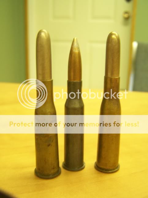

So I went on a mission, and found what I was told to be 8x56R ammunition (pricey, pricey stuff... 1914-1928 dated). Now, they won't chamber. WAAAY too fat. Interestingly enough, she will chamber czech 7.62x54R. The bore on this thing IS 8mm, or pretty damn close. And the bullets are as well, or pretty damn close. (I have no calipers here to measure them).

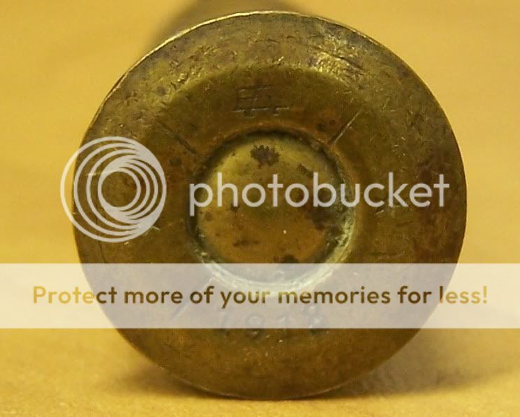

Here's some pictures of the shells, I can't ID any of the markings, I'm hoping some of you can. I put a 7.62x54R in there with them, for comparison purposes. Any idea what I got?
You can get new Boxer-primed brass and ammo for the 8x56R Model 30 from Graf's in the USA. On the other hand, 7.62x54R is close enough that you can rebullet it with a .329" slug after expanding the neck. LEE makes a bullet-mould for the .329 as well as a sizer die/gascheck seater.

Yeah, those rounds are for the Kropatschek or for the Guedes rifle. The Krop was in "8x56R" or so it was supposed, but also called "8x60R"..... different cartridge entirely. There are sometimes confusions such as this with some old gun/ammo combinations, and you were just unfortunate enough to hit one of the weird ones!

Those are not 8x56R, I think they are Portugese 8mm Kropatschek.
Agree, that mark at the top of the case is identical to the marking on my Kropatchek.
