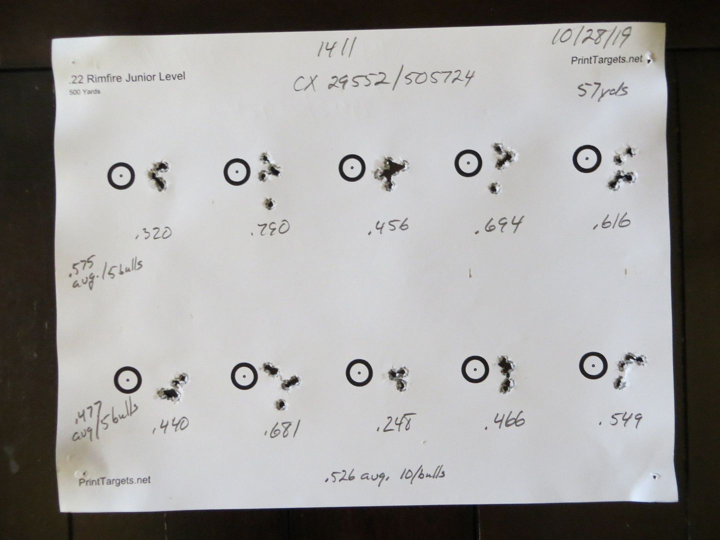

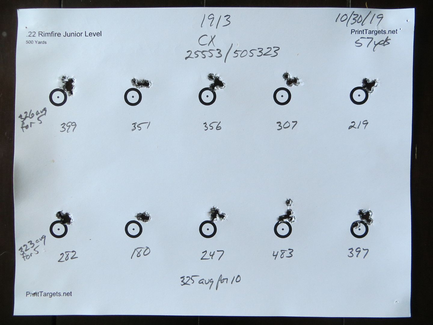

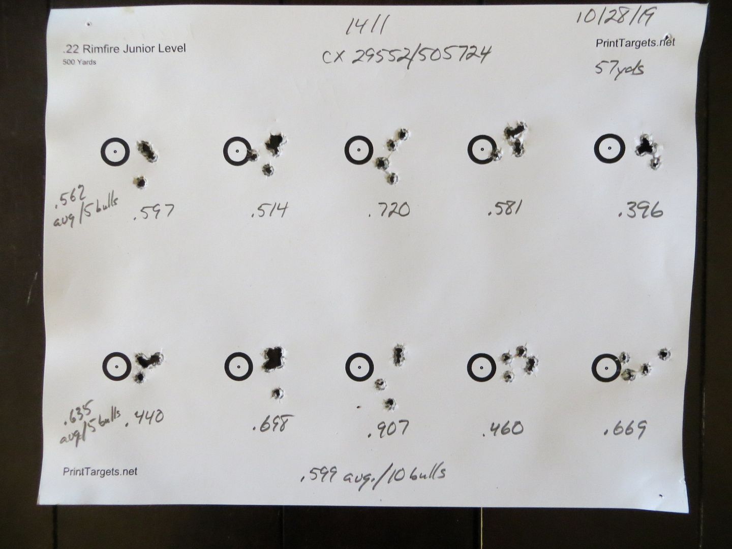

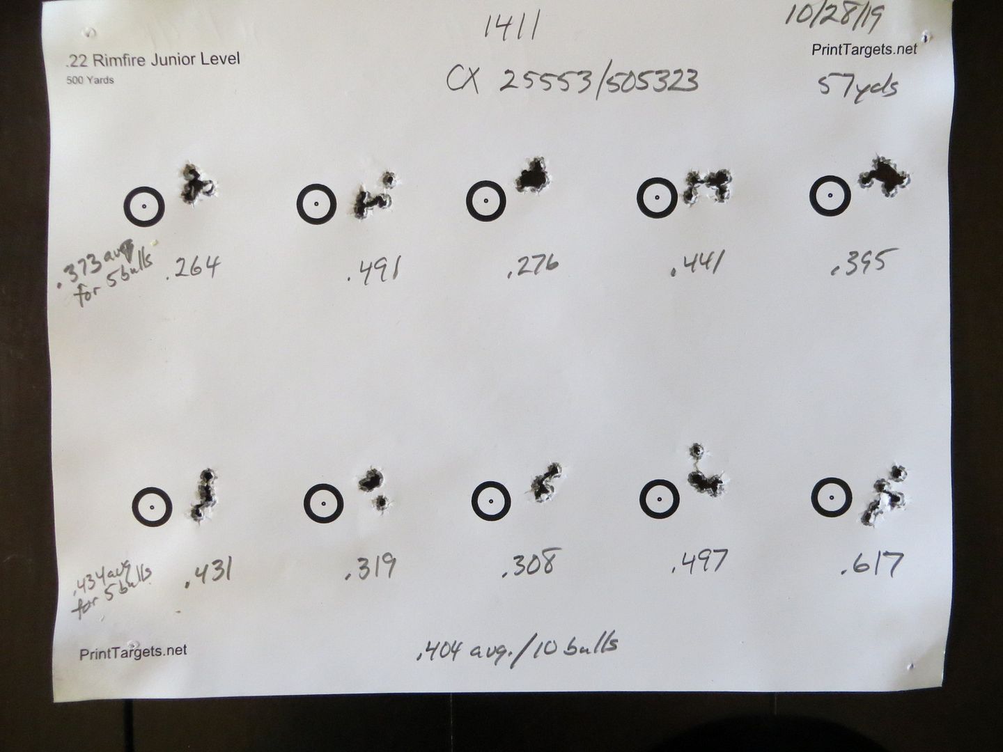

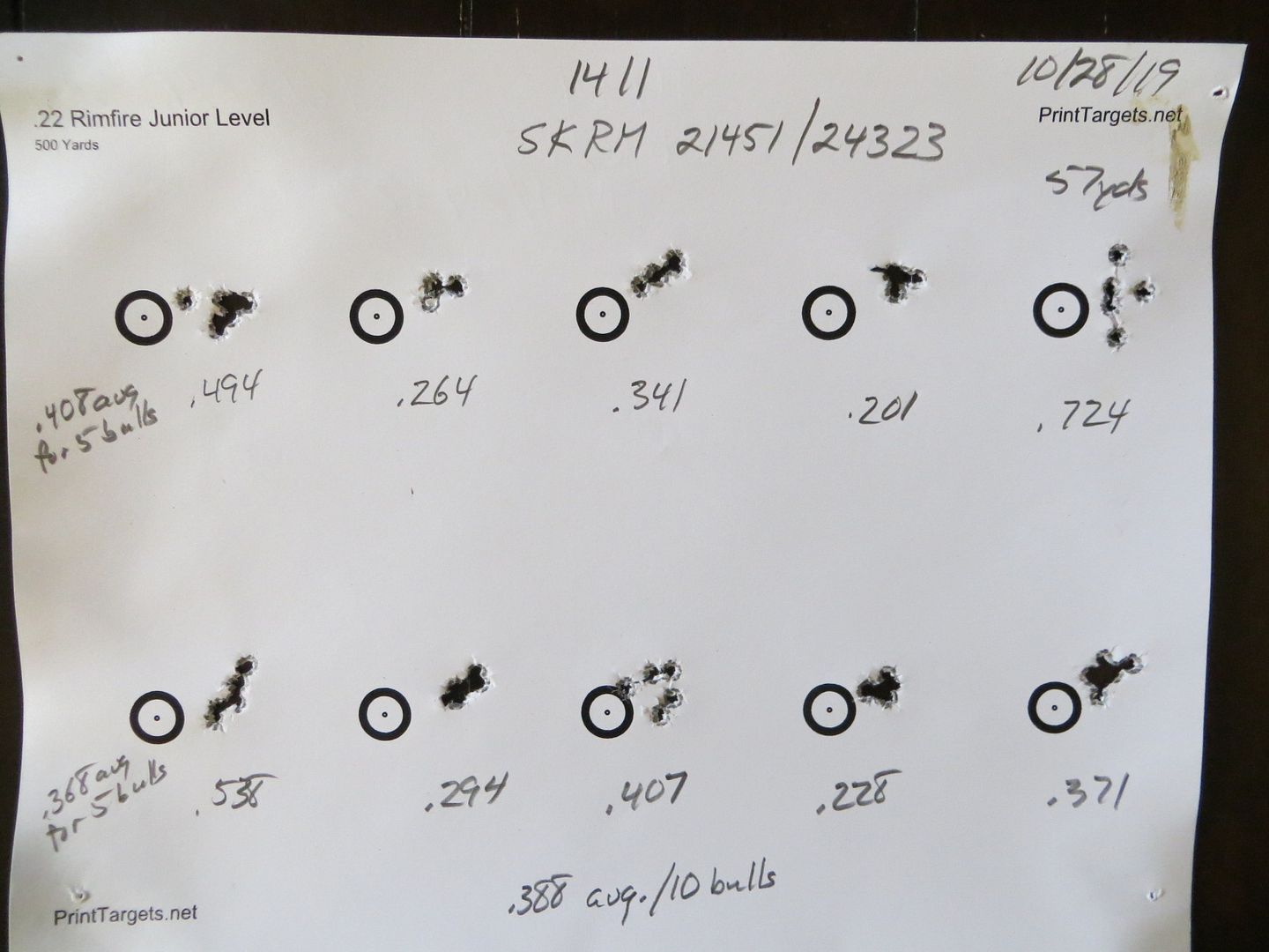

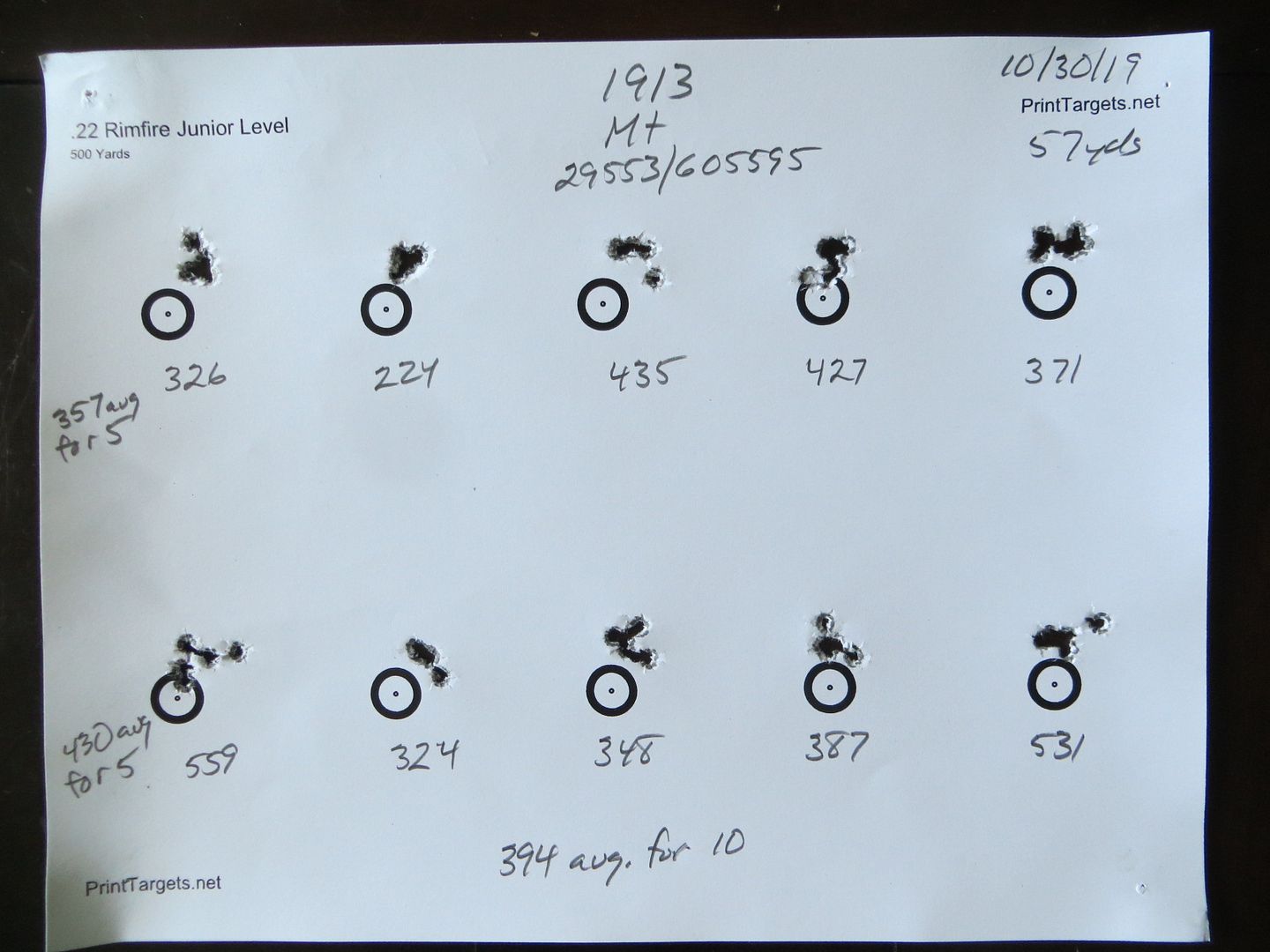

I shot two different lots of Center X and the results were striking. One lot of Center X, which while not producing especially good results, was considerably better than the other. I put the same effort into trying to obtain the best results for each round I fired, despite the unspectacular nature of the targets, which are shown warts and all.
The "better" lot:
The not-so-good lot:
The above results show clearly that not all lots of Center X (or other ammo) is necessarily the same. To be fair, most lots are average and will produce results that are average for that particular ammo. I have concluded that the more poorly shooting Center X shown above is a less-than-average shooting lot of Center X, probably considerably less-than-average lot. The better lot is somewhat closer to average, despite the uneven results.
The point I wanted to illustrate above is that different lots of ammo can shoot very differently. Most lots of a variety of ammo will be average, but some may be better and some may be worse. It's not so much about finding the ammo your rifle likes as finding the lot(s) your rifle likes.
It must be kept in mind, however, that different individual rifles -- even of the same make and model -- may shoot the same lot of ammo differently, that is they may get different results with the same ammo. In turn, ammo that is not especially good in one rifle may shoot better (or worse) in another.

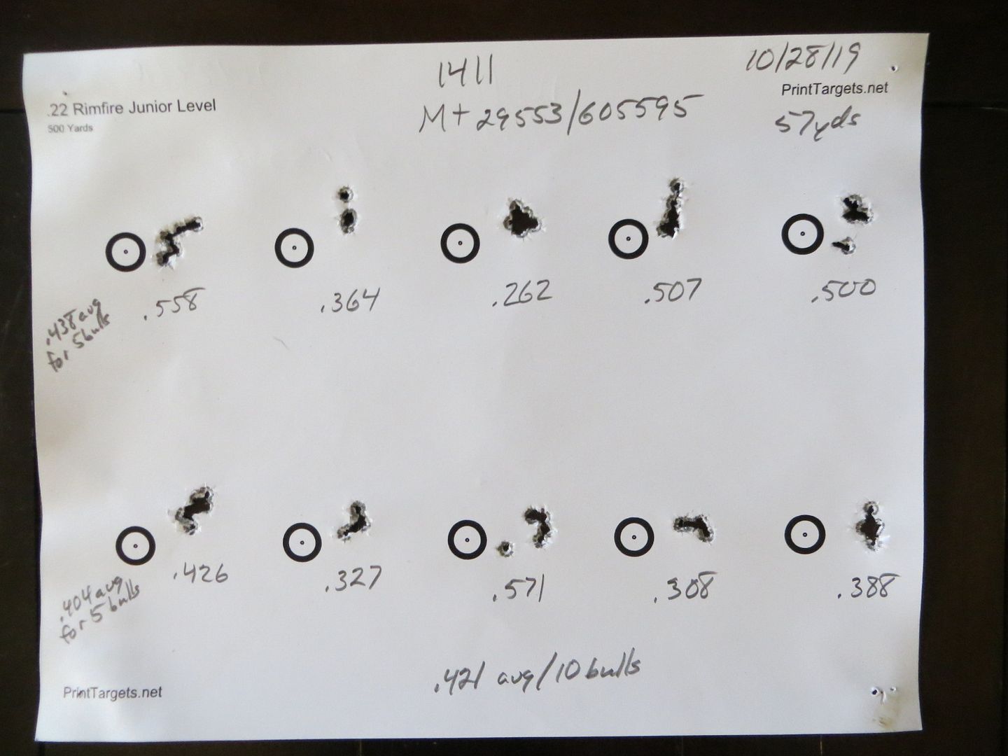

All told, I have had good luck and bad luck with Lapua ammo and everything in between. It's not the make or variety of ammo with which you will achieve your best results. I've had good results with Midas + ammo and bad results. I think I've shot all the "good" lots of Midas + I had at the beginning of the season. What I have left is decidedly unsatisfactory, as the results I obtained today with a box of what I have left shows below.

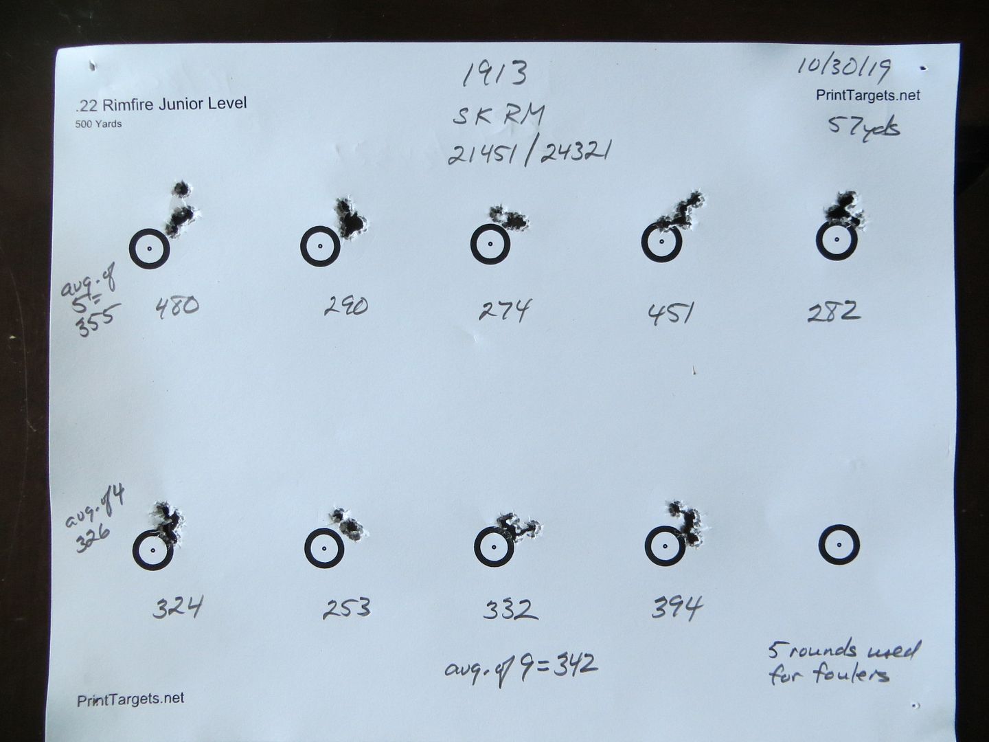

That's especially disappointing for ammo that costs $20 per box. On the bright side, this lot of SK Rifle Match is not too bad, if you can accept that it can't be expected to be as good or consistent as "good" Center X or Midas + ammo.
In the end, the quest for accuracy is about finding the lot(s) your rifle likes.
