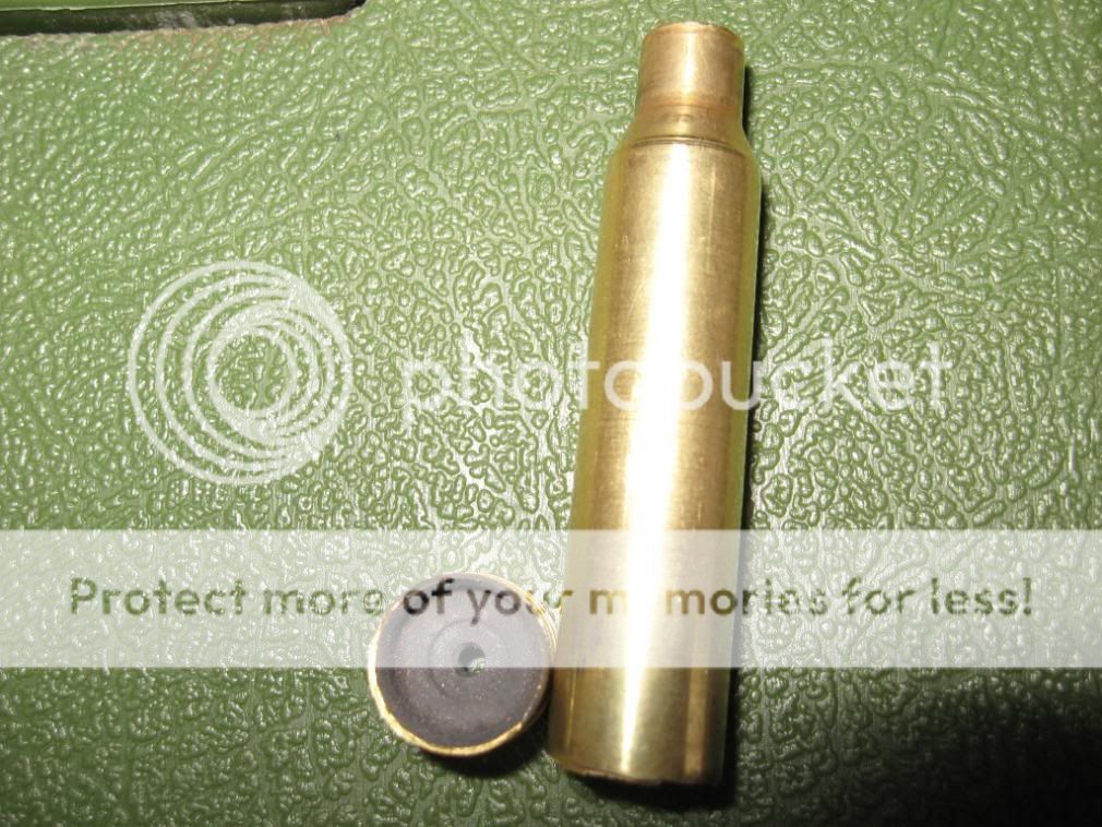

So, after 13 firings, my 300 win mag brass is giving up the ghost.
Out of 150 cases, these were the rejects.
I've placed them in order, from left to right, best to worst.
The ones on the extreme left might not show the "magic line" very well in the pics but I assure you, it's there. As you move right, the failures become clearer. If you can't figure out whats wrong with the one on the extreme right, stop reloading and give up now. :D
I'm posting these to show the new guys what to look for. If you see "that line" starting to appear, toss the case.
Inspect your cases closely after EVERY firing. The one on the right showed the ever so slightest separation line, but I loaded it anyway and kept track of it to show everyone what will hapen. It looked just like the one on the far left before I fired it. I have the tools to extract a separated case from a chamber. I do not recommend that anyone who has cases that show signs of failure try this. I put the gun in a vise and fired it "remotely" No damage to the chamber or bolt, but I don't know how much gas escaped. Note the second one from the right. It has a very small fracture as well. None of the others were cracked, but "that line" is there.
A hard tug with a pair of pliers pulled the head off the one on the right.
I'll fire the remainder one last time with very light loads and cast bullets, and then chuck the lot and start over.
Anyway, hope this helps someone.
Cheers.....Den....

Denny, I hate to say so, but you have been resizing the cases a bit too much. Cases seperate like that from having too much head space. The fact you fired them so many times is proof it was just a bit too much headspace.
When a case has too much headspace, here is what happens. The firing pin drives it foward against whatever it is that holds headspace, in your case the belt. When it fires the case expands and grips the chamber walls. The base is then pushed back to the bolt face, stretching the brass. The weakest part of the brass is just above the web, where they are seperating.

Actually Bruce, I bought these (factory loads) when I bought the rifle. I did full length resize them once around the 6 times fired mark, and again at 12 when I annealed them. I'm using a Lee collet neck sizing die when I neck size. Is it possibly causing this somehow???
EDIT: I should note. The reason I resized them was because the bolt was starting to get a little harder to close when I'd put in the cartridges. I resized, and the problem disappeared until the 12th time I fired them. I resized them again, and things were fine again through the last go around, other than that one on the end showed a ring. I fired them all, and these guys came out of the tumbler as you see them.

So based on this, you have been neck sizing the cases each time, and have full length sized them twice. Twice would be enough if you are doing what H4831 describes. The area just in front of the belt is the usual area to break.
The "web" is the part inside where the thick part of the head curves up into the thin sidewalls.
Back off the die adjustment a bit. Give it enough to allow the round to chamber easily, but not enough to create excess space between the case shoulder and the chamber shoulder area.

blacksmithden, neck sizing is a great way to prolong brass life. Unfortunatly like you have already discovered, eventually you will have to resize or the bolt will be stiff. A little trick I use is to set my sizing die just enough to kiss the case shoulders and that should push them back just far enough for the case to chamber smoothly. You can keep trying to chamber the empty case while each time making a small adjustment on your die until the bolt closes smoothly. By the way this also a good way to size your brass if you don't own a neck sizing die as well.;)
Thanks for the info guys. When things start to tighten up again, I'll try backing off on the die a bit. I've been doing the time honoured "screw in the die until it touches the shell holder and lock it" setup, and I always thought things felt a bit tighter than they should near the bottom of the stroke.

Get a Hornady Headspace Toolset (same idea as the bullet comparator, but for the case shoulder) and set your shoulder back 0.002" from that of a (measured) fired case. I resize with a Redding (bushing-type) FL match sizing die this way. No problems with accuracy, no feeding problems and more consistent velocity from loading-to-loading than with neck sizing. Probably get longer case life than with the usual neck sizing routine too, since the shoulder never gets shoved waaaaay back.
