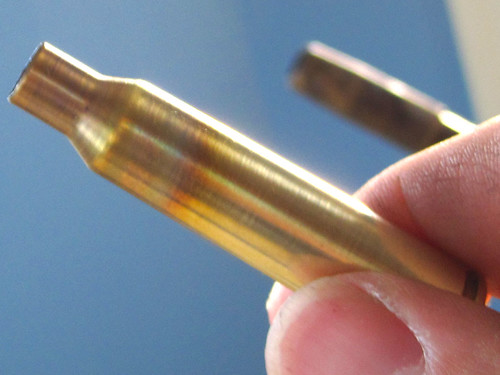

I anneal cases by the ancient method of setting them in a pan of water. I use the torch to heat the neck and shoulder until they glow a nice red, then tip them in the water.
I had no question about a nice red not being the proper temperature, because I have watched, or helped, several aircraft engineers anneal spark plug gaskets before replacing the spark plugs. Aircraft spark plugs use a gasket that is just a ring of solid copper and it has to be annealed every time it is removed. Many of the engines had eighteen spark plugs, so it took a lot of annealing. The standard procedure was to hang all the gaskets on a horizontal rigid wire over a pan of water. They would push a gasket near the end of the wire with a small steel tool and heat the gasket it with a torch. They would heat it until it glowed a nice red, then push it off the end of the wire and let it drop in the water.
Aircraft engineers are well trained and have a great knowledge about what they are doing.
I also anneal the shoulder of the case, because I have had several rifles that required the shoulders to be annealed, or else the shoulder would spring back after sizing and the newly loaded round would not go back into the chamber of the rifle.
I don't remember ever ruining a single case, because of it being too soft, or "over annealing," as has been stated can happen.
I am not trying to tell anyone how to do it, I am merely pointing out I do it and it works great.
