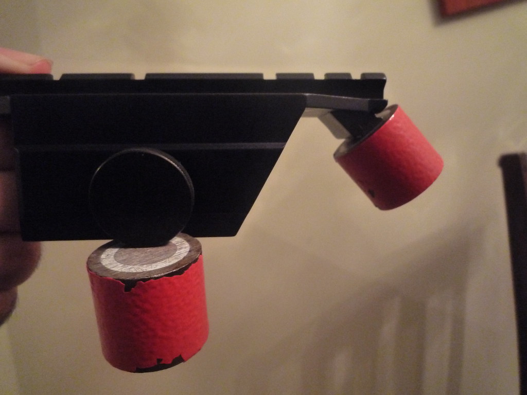

guys, really appreciate for all your inputs. But still, besides the weight, what is the really difference between full steel and aluminum body-type with steel attachments? Sounds like if I put locktite on the screws then makes no difference?
Its main body is CNCed from extruded aluminum, which I am quite sure is either 6061-T6 or 6063-T6.
6061-T6 has yield strength of 40,000 psi ~ 45,000 psi
6063-T6 has yield strength of 31,000 psi.
While:
304 stainless steel 30,000 psi.
The common hot rolled steel we see on a 90 degree angle has yield strength of 35,000 psi.
There is no difference when it comes to strength. Ironically, M14, the great Main Battle Rifle, was replaced by aluminum M16, which is famous for its accuracy.
How does it attach on the front?
It screws to the left side of the reciever, and uses the stripper guide dovetail at the rear, but I'm wondering about the front attachment point.

Nobody who owns both types will agree with that, but go ahead, buy twice and find out for yourself, or just buy a good mount first.
Front is a floating touching point. Just setting on top of the receiver.
It's a steel set screw secured by another set screw. It provides an up-lifting force on the front end of the mount. So the rear dovetail and the front set screw hold the elevation while the side screw secures windage.
They are all like that.
I suspected it might be like that.
If so, stay away from aluminum ones.

With all respect I have to point out that's the common mistake.
You shouldn't "tight up" the front screw. The mount is fixed by the other 2 points. The front screw is just there to hold the elevation. That's the reason there is a second screw to secure the first one since the first screw is not "tight".
I don't have a mini 14 so I can't comment on it. But I know a steel mount will also bent if you tight up the set screw. It's because the middle wheel is on the side so any force will "twist" the mount. You can use harden steel and still see the same result - guaranteed.
