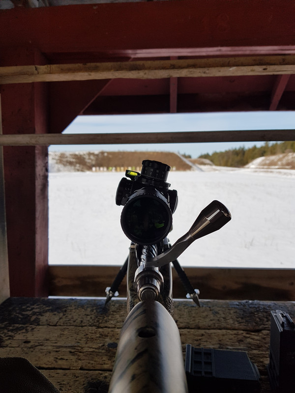

I've got a desert tech rifle with 34mm rings. The ring has it's own level at the bottom. My thoughts are that if I level the scope while the rings are also reading level I should be bang on? Keep in mind this is a 1000 yard + rifle.
Pics to help explain what I'm trying to say.

In theory you are correct. However that is presuming that the cap on your turret is perfectly aligned with crosshairs. More precise would be to use a plumb-bob, align the vertical crosshair with it while the rifle is level.
Maybe I'll try both. If it helps I'd assume a $4500 nightforce scope "should" have level caps, but you never know. Thanks
A piece of true flat bar that would clear the turret housing and your rail would work best. Make sure it touches flat on the bottom of the turret housing and put your level on it off to the side then just move it down on the rail and make them both level. I try not to depend on ring installed levels as they are never right.

Ignore that tiny bubble in the rings, it's useless. Make a plumb, just a hanging weight on a string. Level the rifle off the scope rail, and line up the reticle with the plumb. That will be close enough.
Having the scope levelled to the rifle is essentially inconsequential, what matters is the reticle/scope level with the target.

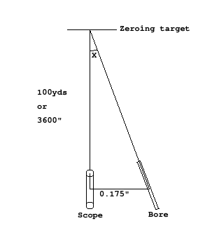

Lets do the math. Pretend there is a 5 degree angle between the vertical cross-hair and the bore of the barrel. How much does that offset the bore to the left or right? Depends on the height over bore. Lets say that is 2 inches.
Doing the math results in an offset of 0.175".
Diagram is looking from directly behind the scope, cross-hairs level.
Now since we zeroed at 100yds, the axis of the bore and the axis of the scope aren't parallel, they intersect at 100yds.
Diagram is looking from the top.
X equals 0.00278521 degrees.
So at 200yds, the point of impact will be 0.175" to the left of the point of aim. So yes, technically, you will "crossfire". 0.175" @ 200yds equals 0.0836 MOA
At 300 yds, the point of impact will be 0.35" to the left of the point of aim. 0.1114 MOA
At 400 yds, the point of impact will be 0.525" to the left of the point of aim. 0.1253 MOA
At 500 yds, the point of impact will be 0.7" to the left of the point of aim. 0.1337 MOA
At 1000yds, the point of impact will be 1.575" to the left of the point of aim. 0.1456 MOA
So much less than 1 click on the 1/4th moa windage turret. Or a fraction over 1 click of a 1/8th moa scope.
Like I said, inconsequential. If you can read the wind to the degree that you can shoot the difference of 1.5" at 1000yds, you shouldn't be down here shooting with us mere mortals.
A simple level over the scope rail and a plumb line for the reticle will get you close enough that you will never notice any error.
