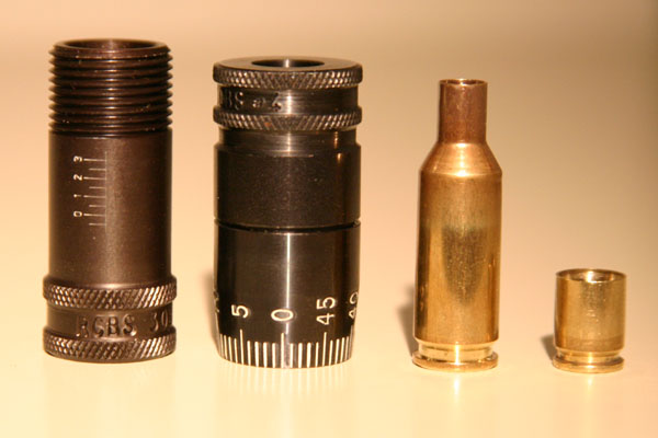

You can measure "headspace" using an expensive micrometer tool, dedicated to a particular round, like the 308 Winchester, or......
Why can't I just place a 38 Special cartridge over the neck of a freshly sized 308 cartridge (or a larger or smaller pistol round over something different), measure it from 308 base to 38 Special base, and compare that measurement to the length I get when I substitute a 308 round fired in my M14? The 38 Special round will be a fixed length and its mouth will sit on the same place on the shoulder of the 308 (not the SAAMI location necessarily, but the same location).
You are comparing your dies with your gun's chamber and the difference (e.g. 0.013", +/- 0.002") is what really matters, not an absolute number like 1.635" that does not consider your die's tolerances - right? Then you can adjust your dies to tighten or loosen the tolerance as you see fit, i.e. F/L, partial F/L or neck size - take it to whatever you like, e.g. 0.008".
