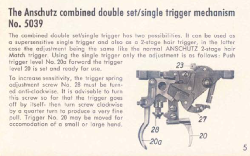

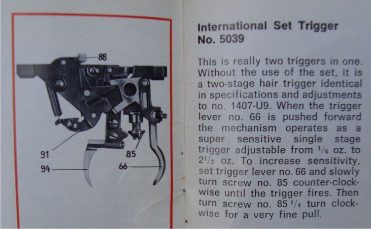

Below is a general instruction for the 5039 International Set Trigger.

Screw 85 in the diagram simply limits the amount that the trigger can move forward, thus, the sear can engage(the sear is in the notch above where the #91 line makes contact with the trigger assy), and the tail end of the sear lever (part of item 88) is that little pointy bit you can see in the sear notch in the image.
Is where I would start anyways. Check the mount screws. Turn Screw 85 in a quarter to half turn.

See the instructions in this older instructional blurb. Note it has numbers that differ from the previous instruction.

I still lean towards that the best course of troubleshooting, would be to start by releasing the tapered screw (28 in the above picture) and allowing the sear to take the engagement a little heavier than it's lightest possible settings. It would have to be easier to feel too, I figure...
