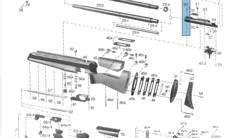

Does anyone know what kind of tool I need to turn these screws or where to buy a tool?
The holes are completely round.

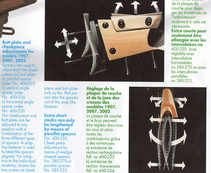

I don't know much about Anschutz position stocks so this might be off the mark. Below are some stock adjustment instructions for a mid-1990s vintage wood stock for a 1907. The spacers referred to below are shown in the parts diagram. This is part 46a (400-234).
Like Glen has said the two screws with a long 4MM allen wrench will allow adjustment but spacers were used to pack out the pad and Anschutz sold asymetric spacers for this to provide cant. The but worked on the same system and many companies copied the design of theses spacers as it allowed them to be installed without removing the pad or cheekpiece. Its to complicated and you should just sell it Gian. I might know someone haha!! Double gun classic tomorrow in Oshawa. Just sayin

I've tried every size Allen key and nothing works, the holes in the in the Center of the plastic locks are perfectly round. Thinking I might need a 2 pronged wrench to grab ahold on the sides but hoping there might be a proper wrench from anschutz so I don't mess them up.
The plastic blocks are not how it’s adjusted! Behind the pistol grip on the underside should be two socket head 4 mm Allen bolts. This is how it’s adjusted. The plastic blocks hold a threaded insert into which the bolts are threaded!. Inthe exploded diagram that Glen posted the part number is 46D. DONOT try and turn the round plastic inserts
Thanks I saw that after I looked at the schematic all good, crisis averted.
