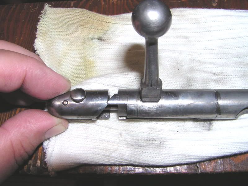

Bolt should have a gap with the protrusion, into the notch like so:
If there is no gap then hold the rear piece in one hand, the middle piece in the the other, rotate so that they do align and stay cocked. Watch you don't get pinched!!
Notice how the flat part of the forward section of the bolt is about 30 degrees to the bolt handle. It should be so when reinserting the bolt into the action. It moves around very freely, and comes apart if rotated 90 degrees.

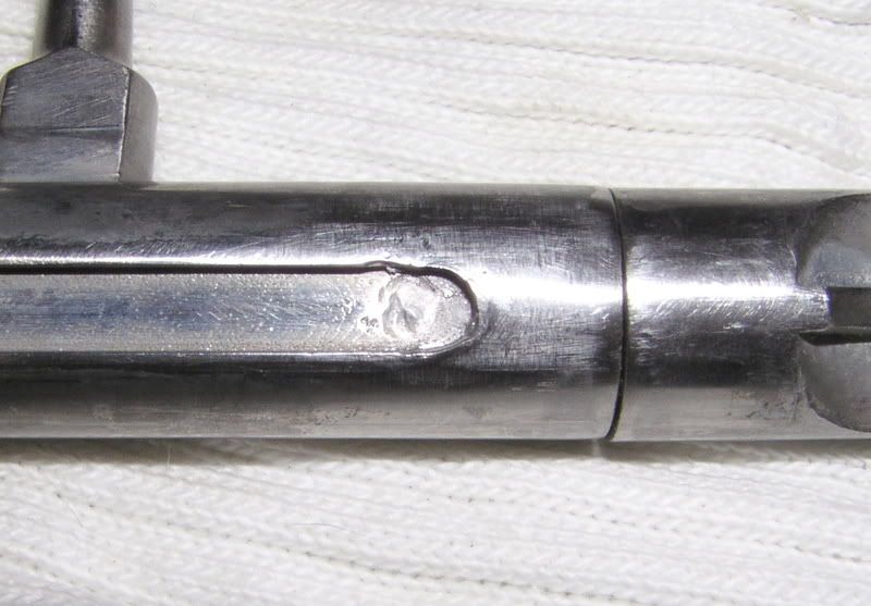

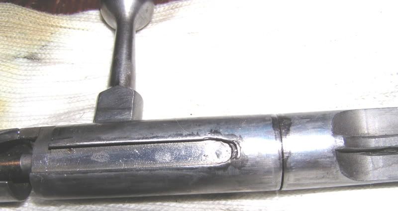

B) Check the sear cutout on the bottom of the bolt. See if there is any peening, like so:

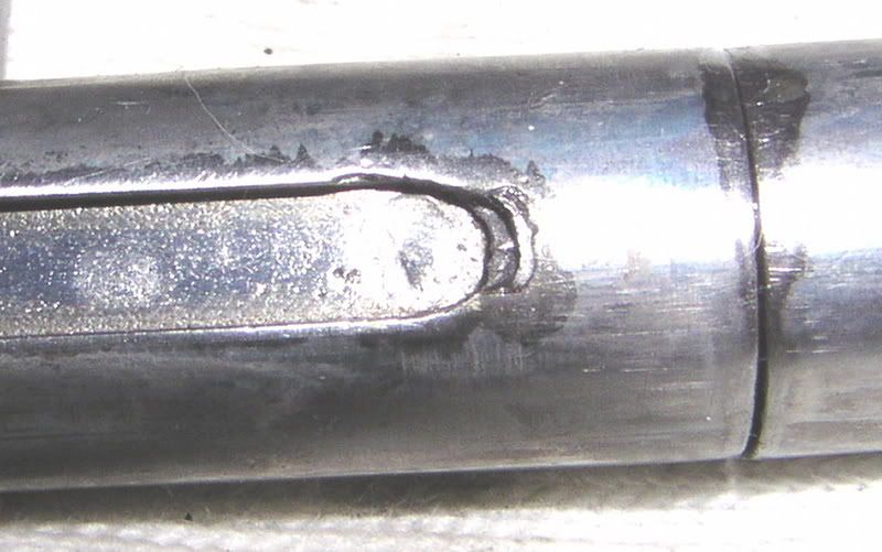

Close up:
If this is the case, best bet would to to have a machinist redo the the end so the peening is gone and you have a nice even slot all the way down to the rest of the original slot. Failing that, try to find a small milling bit and a drill press. I have done a few with a flat tipped round file.
