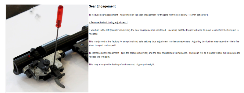

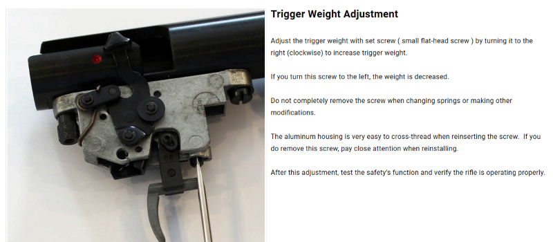

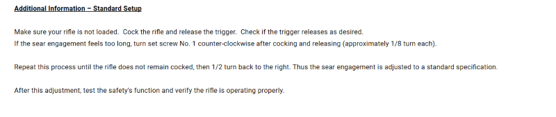

It's possible your trigger is out of adjustment with the result that the safety doesn't work as it should. The following is from the Anschutz North America website's maintenance section h t t p s://www.anschutznorthamerica.com/maintenance-tips.html

I concur with grauhanen, trigger adjustment must be slightly out of spec. The trigger instructions clearly specify to test safety function after any adjustments. I would turn the sear engagement screw clockwise 1/16th-1/8th turn. You will not void any warranty by making minor adjustments to the trigger as outlined in the user manual. Your trigger may be great for a bench only rifle where the safety is never used... but as you clearly use the safety... adjustment is required and my money is on the sear engagement. What are you afraid of? You turn a screw 1/8th turn one way... it doesn't work... you just turn it back :)
It's simple enough to try, but now I feel obligated to wait for a response from Anschutz. I already told them I haven't made any adjustments myself. If there's been no response before the next time I want to take it out however....

An Anschutz expert I got ahold of advises that the 1/8 turn trigger (sear) adjustment is probably what's indicated for a safe safety, says from the sound of it that my trigger is set 'way lightly for a new from the factory rifle, but of course I do like it that way for target shooting. If that's indeed all it is, I can live with it for bench shooting but not for hunting (even though I don't use a safety for that, having a rifle that discharges when the safety is touched or bumped is for sure potentially deadly), and certainly can't leave it as is for passing the rifle on. Anyway, I've yet to hear from the Anschutz people directly, waiting for that as final word.
