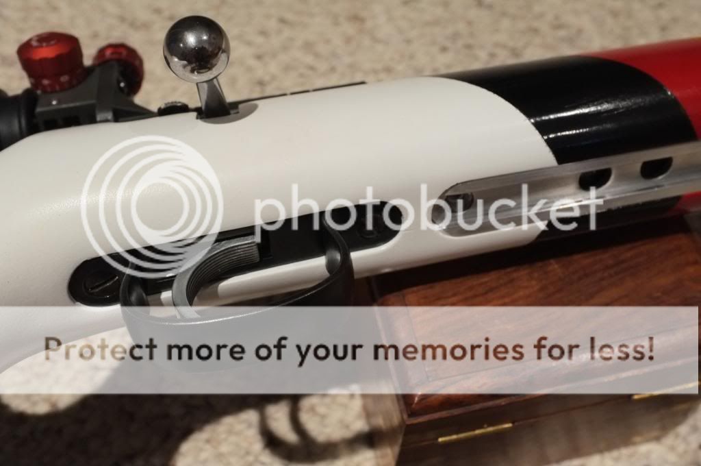

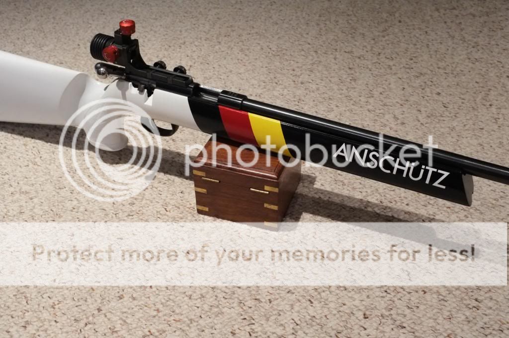

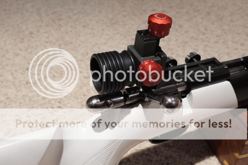

Hey guys, thought you might want to see my Anschutz CIL 190 makeover I recently completed. I was fortunate to find (with the help of a great CGN'er) a decent condition CIL 190 from a gentleman in Quebec. The rifle arrived to me with the usual dings and dents of 45 years of use, along with almost every part being covered with a shellac of dried oil, cat hair and spider nests. Clearly the rifle hadn't been shot in a long time but given the extremely low price I paid, I wasn't about to complain. None-the-less, it was all cosmetic and I set about to do a makeover. I laboured over the decision to paint the wood or not. My gun safe is full of walnut already, so i decided to make this rifle a tribute to my German heritage and the rifles manufacturing home. All the parts cleaned up beautifully with some elbow grease. The only cost to me was a new rubber eye cup, and the red knobs. On the website where I ordered them it stated they were compatible with the "old silver knobs" so I gave it a shot. Unfortunately the base that the knobs mount to is not tall enough for the set screw to grab, but the diameter and fit is nice and snug, so I just glued the knobs on with super glue. Easily removed if needed.
So here she is, all dressed up and ready to go to the range...

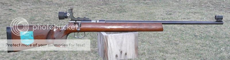

Before:
After:

Might I ask where you sourced out the red annodized adjustment knobs?

How did u manage to get the letters and colours so perfect? Sticker of sorts?
I hand cut the lettering out of adhesive vinyl with an Exacto scalpel. I'm a commercial artist so that comes easy for me. Takes about 10 minutes per word. You could also have them cut by a commercial vinyl cut machine.
Colours are masked and painted with Krylon.
