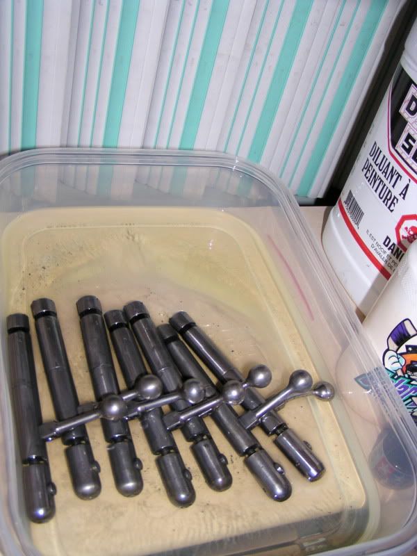

Yes that is a considerable Anschutz Bolt collection.
