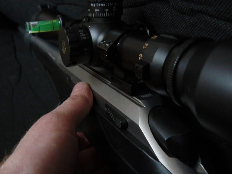

Here's one I made. I think it cost me less than 2 bucks.

I'm not advocating the high up level any more than the side one, it just happens to be the one I found at a price I was willing to pay at the time.

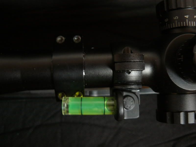

Have the B-Square one - needed to shim it for it to be level.
Simplest is a popping the level out out of a line level or something similar and epoxy or otherwise fix it in place on the rail - here 2 for 99 cents

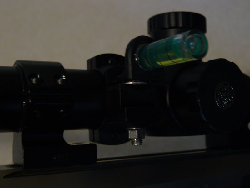

thx guys great plans. zimbu, got a step by step?
You need a ring with enough material on it to mount the level. The angle is 1/8" thick 7075-T6 aluminum angle with the pivot bolt hole reamed .0015" interference and the level hole reamed .0005 interference. I put a swab of 5min epoxy in the hole before inserting the level. The hole through the ring is reamed transition fit so it pivots freely. The upper side is milled off somewhat flat with a file and the lower side is spotfaced so the nut pivots freely.
