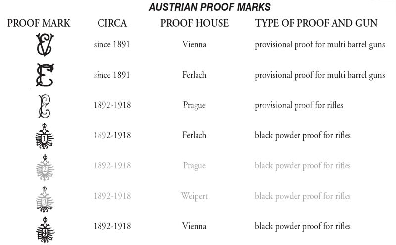

Austrian Proofmarks

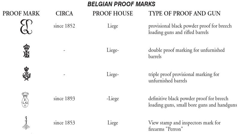

Belgian Proofmarks
Pre-1893 Belgian Liege Proof; This proofmark denotes the gun was manufactured and proofed prior to 1893. It's an E over LG over a star inside of an oval. It looks like this;
Note, this claims to be for rifles but has also been used on pistols.
Post 1893 Belgian Liege proof is the same and just has a crown at the top of the oval. Be careful with the gun and be able to verify the maker and gunsmith production date with post 1893 if attempting to verify as antique. RCMP rarely give factory letters for post 1893 Liege Proof.
Belgian Inspectors marks
Pre 1877 Belgian inspectors marks were designated by a Crown above the inspector lettering, other than known proofs that included a crown. Crown is different style with only 3 lines making body of crown instead of usual 5 (two outside lines and one middle, will source a pic soon).
Post 1877 Belgian inspectors marks were designated by a star above the inspector lettering, other than known proofs that included a star. Star is different style with top point being smaller than typical Belgian proof (seeing if I can source a pic).

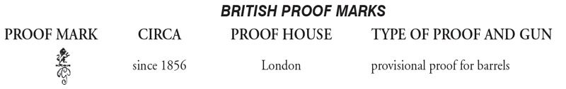

British Proofmarks
The following two graphics are provided by Steppenwolf (Appendix D & E), sourced from Howard Blackmore's British Military Firearms 1650 to 1850;

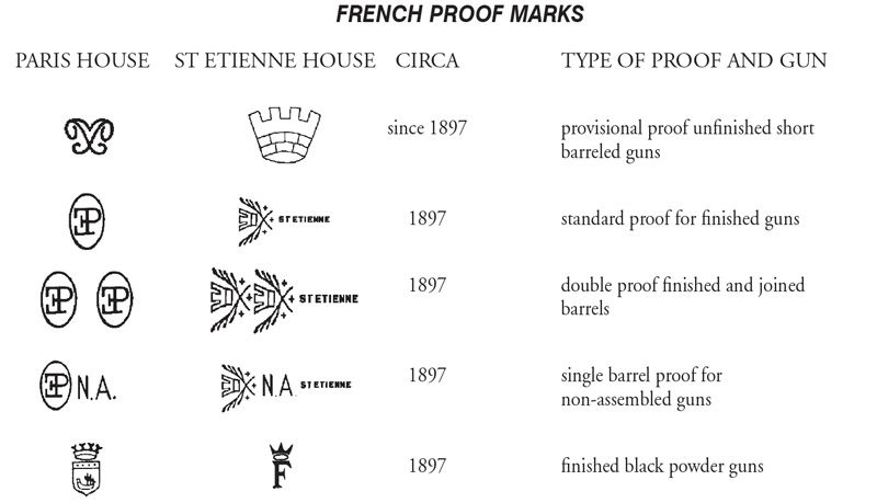

French Proofmarks
French Model 1892 Serial Range - Courtesy drslav, find more info in French model 1892 8mm revolver all you need to know.

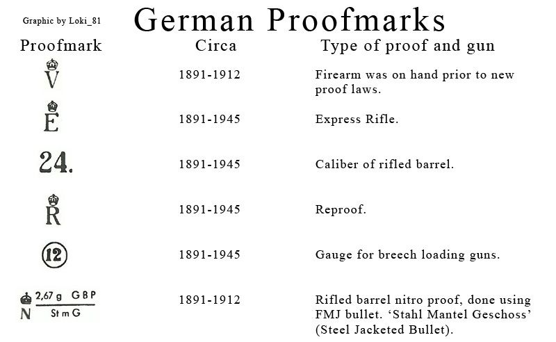

German Proofmarks
Note; When the preliminary proofmark and the German viewmark 'Untersuchung' appear together it signifies a black powder testing and examination upon completion of the firearm.
Note; The other markings that can be found instead of the Stahl Mantel Geschoss "St m G" marking are "K m G" for Kupfer-mantel Geschoss (copper jacketed bullet) and "Bl G" for Blei Geschoss (lead bullet). The 2.67 GBP signifies the powder charge used in the proof, in this case it means 2.67 grams of Gewehr Blättchen Pulver (military flake powder).
Vorrat Proofmark. Firearms built prior to the change in German proof law weren't proofmarked, this marking signifies that this firearm was manufactured prior to 1891 when the proofmark law came into effect. - Provided by vagrantviking.
This proofmark is distinguished from the English view marking mostly in that the Crown is the German Imperial style and staight lined where the English View is a rounded crown. The "V" is also a different style with the Vorrat having a wider left side than right.

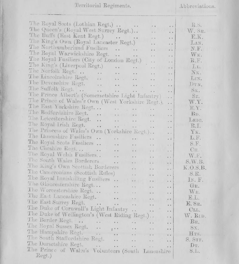

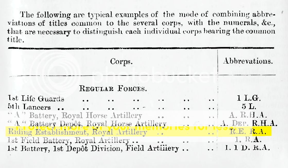

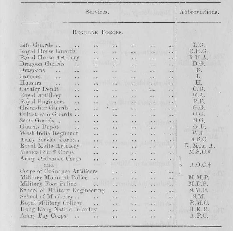

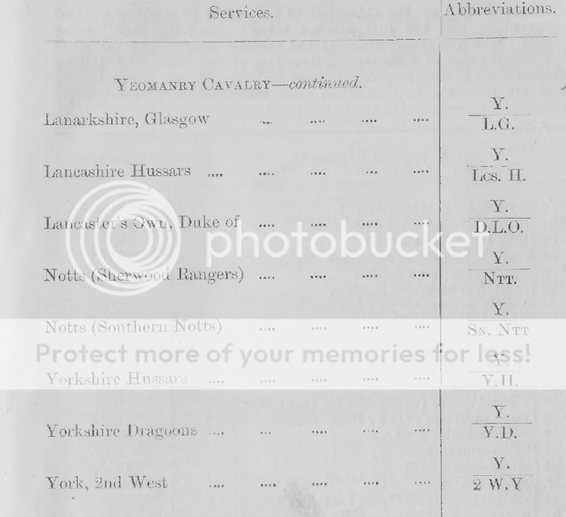

The following comes from the War Department's "Instructions to Armourers, 1897" .... specifically Appendix I thereof, which sets out the various approved abbreviations for marking small arms: - Provided by GrantR
Severn ........................................................ SEV.
Shropshire .................................................. SH.
Shropshire and Staffordshire ........................ S. & S.
Sligo..............................................................So.
Somerset, North .......................................... N. ST.
Somerset, West ........................................... W ST.
South Wales and Severn .............................. S.W.S.
Staffordshire................................................. STF.
Suffolk ......................................................... Sic.
Surrey .......................................................... SR.
Sussex........................................................... Sx.
Sutherland ..................................................... STL.
Tay ............................................................... TAY.
Tees .............................................................. Ts.
Thames and Medway ..................................... T. & M.
Tipperary ....................................................... TIP.
Tower Hamlets .............................................. T.H.
Tyne .............................................................. TYNE.
Tynemouth ..................................................... Tarn.
Warwickshire ................................................ WK.
Waterford ..................................................... WD.
Westmoreland and Cumberland ..................... W. & C.
Wicklow ....................................................... Ww.
Wiltshire ....................................................... WES.
Worcestershire ............................................. W E.
Worcestershire and Warwickshire ................. W. & W.

Austrian Proofmarks
Belgian Proofmarks

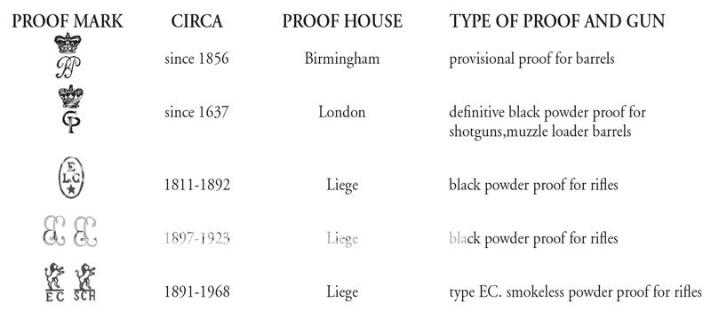

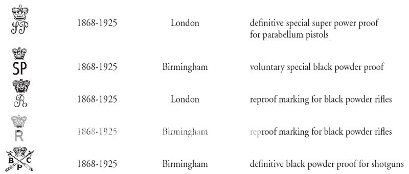

British Proofmarks

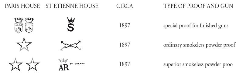

French Proofmarks

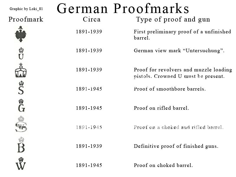

German Proofmarks

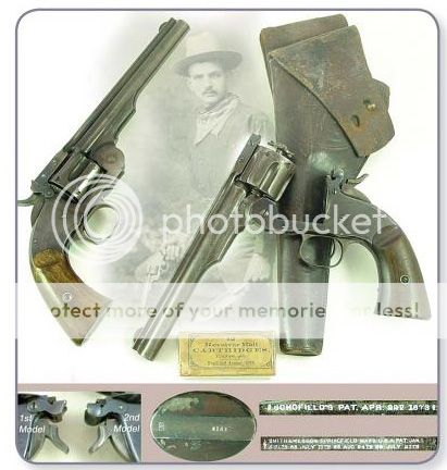

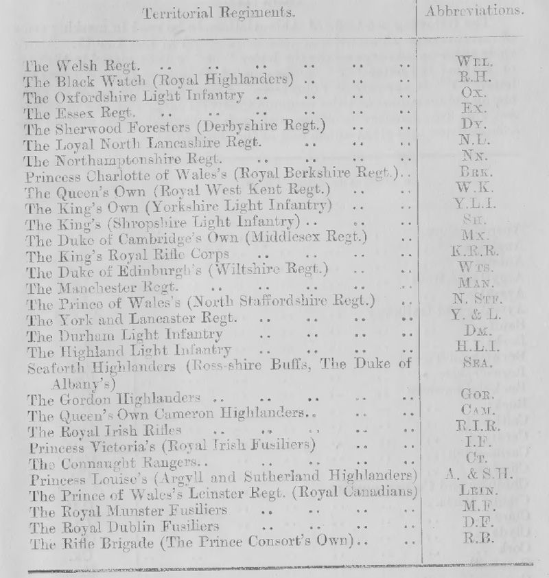

Schofield are antique by date of manufacture, including models 1, 2 & 3. **FRT printouts required here if someone can provide them**
US marking on bottom of grip denotes service in the US military. Appears on toe of first models, moved to heel for early second models up to about serial 6000 then back to toe on subsequent production.
1st model; Inspectors marks of "L" and "P" on various parts, grips have inspectors cartouche of "JFEC" or "SBL" on left grip.
2nd model; Inspectors marks of "P" with either "E", "C", or "W". Right grip either plain or marked "CW" and left either "JRJ" with date, "CW" with date or "DAL 1877".
Illustration of difference between 1st and 2nd model latch.
