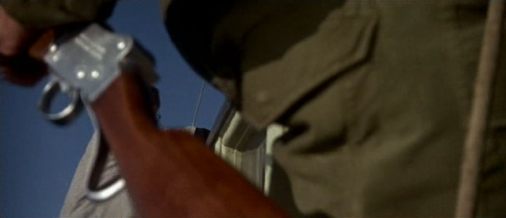

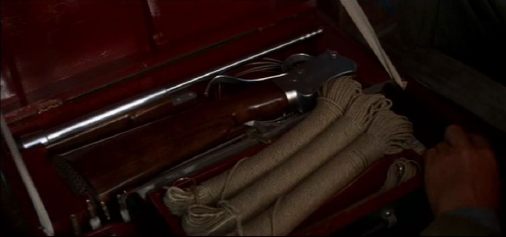

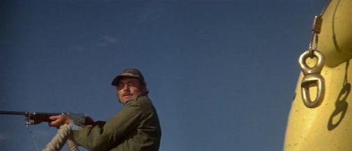

Ya i was watching the orignal Jaws again :rolleyes: And i noticed that Quint was useing what looked like a Martini Harpoon gun.
The Action was Martini i got a couple good looks at it.
Was this a Fake or did they make Harpoon guns like that??

OK, three "screen captures" from "Jaws":
And here is a better picture of just such a cased Greener Matini-action harpoon gun:
