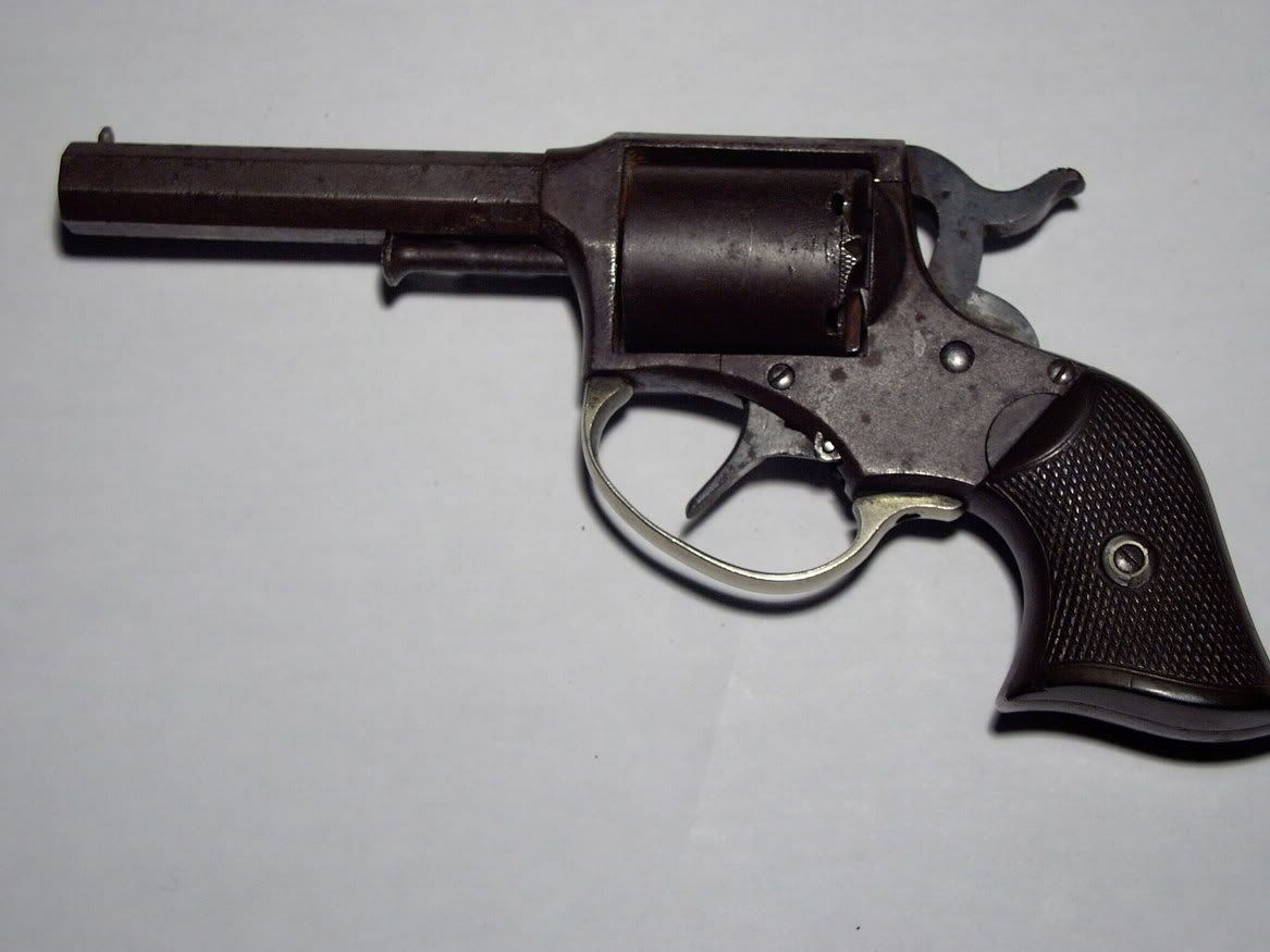

Hi,
I'd like info on what permit is needed to keep an antique pistol that is .31 rimfire cal. or is it considered as antique, I don't know, maybe you guys will know.
Also, what would be the value on such a piece.....:confused:
The pistol is a Remington:
Manufactured by Remingtons Ilion NY
Riders Pt AUG 17 1858 MAY 3 1859
3” Octagon barrel
5 shot straight shaped cylinder, (not the mushroom shaped one)
.31cal (not sure)
Straight trigger
Brass trigger guard
The handle has some brown (look like) plastic cover, not wood

My belief is that it does not need to be registered.....pre-1899 and antique... and no ammo available. No PAL needed to acquire or purchase one either. The only regulation which applies are the safe storage rules...which doesn't make much sense but I do understand that is the case.
The FRT shows this as a Remington-Rider Pocket model, chambered in either .31 Percussion (1860-1873) or .32 short RF (1873-1888).
The firearam is listed as Antique in the FRT. Get it verified and keep the paperwork.

Thanks bussard,
Any info on value of the revolver in your book?
Also, should I leave it as is or redoing the blue would affect it's value?
This revolver was found around 1958-59, wrapped in a towel, hidden inside the rear fender in the trunk of an old chev 1939 in Tweed, ON. That's all the info I have about it. I am really happy that it is considered as an Antique but will have it verified like you suggested to make sure and have the paper in order.

Don't refinish it, even if there is little or no finish on it now, reblueing it will reduce its value by at least 50%-75%. A worn but not refinished pistol is much more collectable than one with a new coat of blue. Nothing wrong with something being a hundred odd years old and looking like it. Your pistol shows honest wear, that is part of its character.
Gently clean it with extra fine steel wool and gun oil, nothing more. Remove dirt and rust, but don't clean it too vigorously, otherwise you will polish the surface an remove the patina that time took generations to produce. That can't be faked, that is why it is important to leave it alone.

Paper work all done..:)
Went tonight to meet with a verificator and as you guys stated, it is considered as antique, and the paper work...laughing, it's just a sheet of paper that says what it is like model, cal, action etc with his verificator # and name. No need of any permit or other paper.
He told me to keep the paper as proof of verification and I should be ok but to treat it as a regular revolver meaning locked at all time. Don't have any problems with that.
